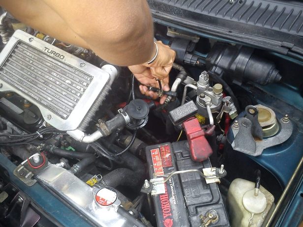

I just wanna inform u guyz that my co-worker currently playing Plug n play with his Kancil 850..
the specs are :
- L2 head, turbine, intercooler, computer box
- stock/standard piston, con rod, crankshaft, bottom..
i've told him about the engine internal is not too strong.. but he still wanna go on with it
Any advice u guyz wanna give him?

anywayz, how much boost u guyz think it's save for this 'hybrid'?
0.5 bar? i think..
Ya me too. As long as not exceed 1.0 bar is still ok. If tekan kaw-kaw, 0.5 bar also can pecah.

but from my fren, its ok as long as boosting below 0.5bar... but don't revv more than 6krpm.... get a oil squirters for the pistons as well

I think it is fine... General rule of thumb is keep 0.4 bar and below. 0.5 is risky already. For a bit more detail concerning flow, hit up bro xtremeleo.
Also, don't forget metal head gasket. Thicker ones, >1.2mm better.

id get a 1.8mm, or better yet a 2mm
Bro... Yes la.. but if the gasket too thick, wouldn't the low end torque suffer a bit? I mean before the boost kick in...
the high compression pistons will take care when boost is off, plus there is a way to tune for response for this kinda setup :)

So for low boost, the combination should be something like:
high comp pistons + thicker gasket
or
lower comp piston + not so thick gasket
is it?
if tight budget..stock 850cc piston+thick gasket...
and pray for the conrod to withstand the pressure....boost not to exceed 0.6bar...if boost spiked during heavy acceleration..pray hard.... :biggrin:
