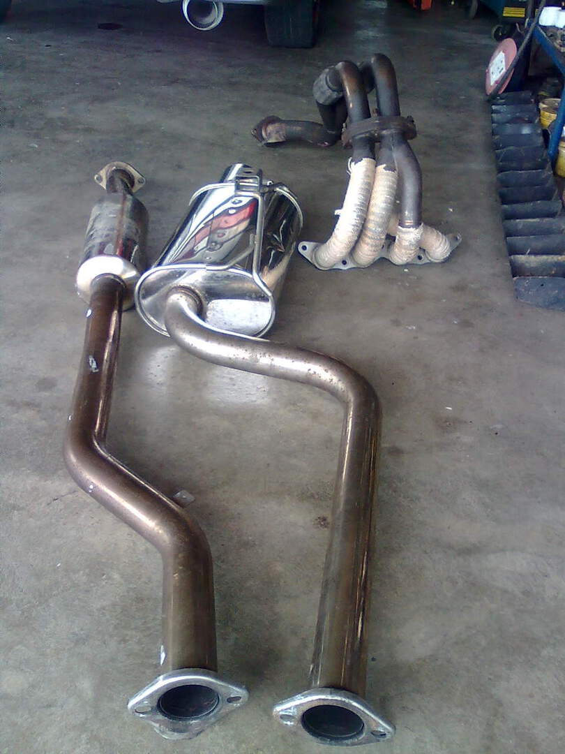

Want performance but in the same time not hurting ur ears, choose straight flow but with big barrel like l've attached..l've tried s-flow and my conclusion, it couldnt satisfy my expectation..quiet, yes but performance, need to step ur pedal even more to make the car moving
agreed with you.. stock exhaust more pikap than s-flow even with aftermarket extractor.. erm..
