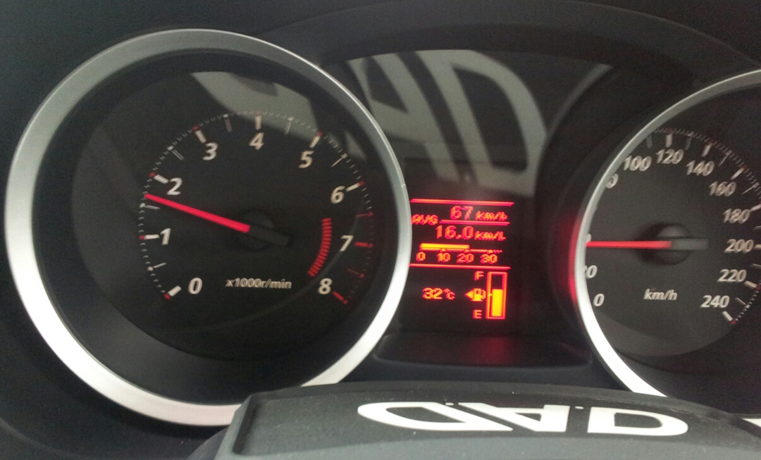

Inspira Fuel consumption
Inpira 1.8 mt.stock engine..k&n drop in filter.
Retune ecu..for better pickup n topspeed..
70% hiway 30% normal road.
Air cond on...
3 adult inside the car..
Maintain 100kmh on hiway..just 80km distance
This my fc
