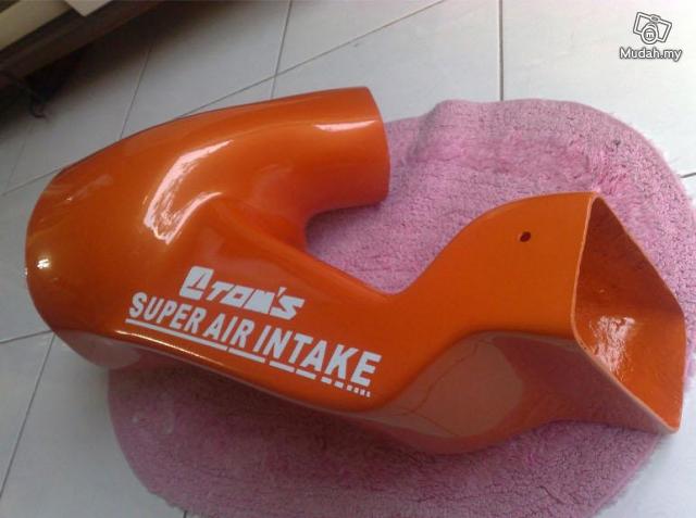

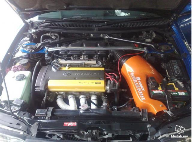

it's better if u can get sumthing like this pic..
it uses all the available space of ur engine bay
:biggrin:
:biggrin:
looks monstrous. super big. hahaha
