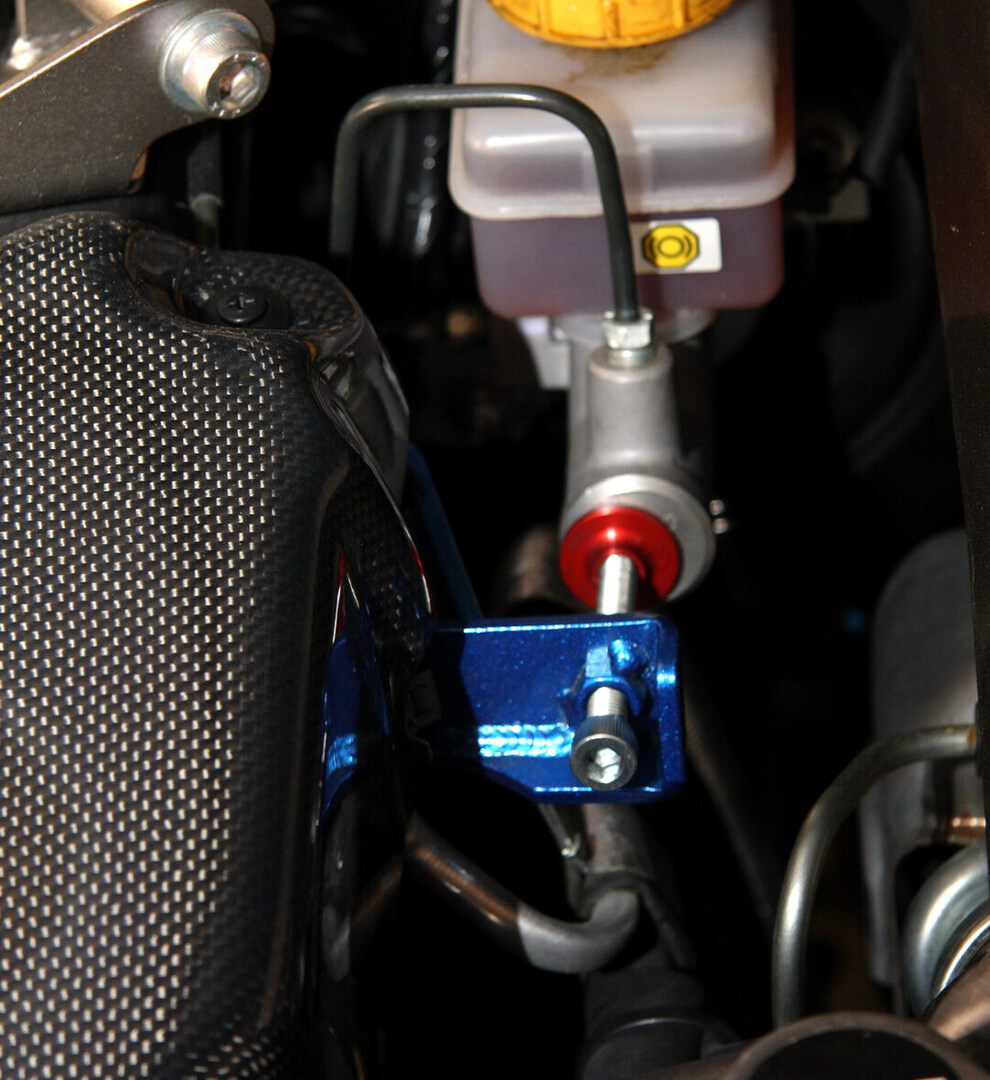

attachment.php
Could you elaborate a little how this brake stopper works to improve braking performance?
Thanks.
Brake stopper works like giving u more harder pedal feel by minimizing firewall flexing when u pressing the pedal, give u more precise control over braking.

3. Brake stopper. These little things stop or lessen the firewall flex when the servo is active giving you better brake pedal feel.

Bendix heard of it before, might try on Kelisa and also the Brake stopper can get anywhere?
Pro RS should be good enough. Is your car firewall so soft, to use brake stopper?

So since dayline mentioned brake stopper helps, so thought maybe can try...
