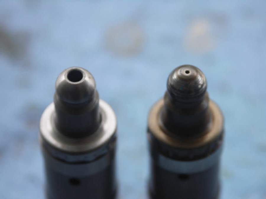

Somehow it never worked on my car before??!! Despite a modified, shimed and supposedly high flow oil pump. I also shim my lifters... Took my oil pump apart and put it back together, place the oil pressure sensor on the head and then the block to measure the psi. Had baffel plates designed for the engine and crank scrapers installed to increase pressure but them darn bullets still sing :(
But what I can tell is that the lifters do fail and low oil pressure contributes more to the noise. I have personally seen and molested collapsed lifters before and they do fail.
Maybe is the inherent design flaw of the lifters or the oil pump or maybe its just my motor becoming an old fart like me or mechanics trying to make a quick buck from me. Whatever, I personally think shims are temporary solution for mitsubishis'. Sooner or later wear and tear will get the better of it and you will need new or aftermarket lifters. Even with uprated lifters there is no guarantee that it will stay silent for years to come vis-à-vis wear-n-tear. My advise is, use good engine oil, change the oil often and take care of your car. Low budget go for the shim fix, bleed/clean the lifters and pray hope it works. But please take into consideration labour and time cost since still need to take out oil sump/pump or head assembly (valve springs, rocker etc etc). If got budget... I'll say the dirty word... go for the lifters. I think they sell them for a reason and coz there is damand for them things.

tony, iam usinga 4g9x engine also, and have had my share on dis lifters problem. the noise was unbearable, so i searched for a solution and found out dat the lifters often get blocked in the inlets, hence blocking oil from entering it and dat is the cause of the ticking.
to rectify dis problem, i used a known engine oil dat has high detergent level, to clean the carbon blockage in the lifters' inlets. dat quieten the noise, but i wasnt satisfy so i got my hands on an engine oil dat has high contain of moly, to buffer and cover sum of the wear previously done from oil starvation. now, its okie and the more i changed the oil containing moly, the quieter it becomes. it has been my 3rd oil change, and the noise is negligible but ive yet to compare the noise to urs. my engine sounds normal now, but may not have been as quiet as urs. iam gonna do the shim mod on the oil pressure valve, and will give feedback once its done. hopefully its gonna get quieter as i wont accept any 4g9x as "engine mesin jahit", lol
bro, this method is quite widespread recommended on the internet, using high detergent oil to clean the engine. however, i must say that its not going to be very effective. i too have tried it before. firstly, carbon built-up inside the engine takes quite a bit more than oil to clean/get rid. secondly, the clearances within the lifters are so tiny that gunk is not likely to be built-up there. even if it did, it would take a significant amount of pressure to wash away (needing like a high powered jet spraying directly into the inlet hole). what is more likely is the type of oil you're using contains properties which somehow allows it (oil) to stay up in the engine block longer, hence giving ur lifters more oil to use.
