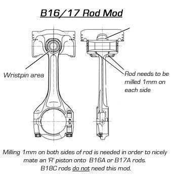

Sifuss need some advice .
How good is a type - R piston into a b16A block ?
What the diffrence between type R B18CR piston and B16B piston ?
Which is higher and which is better ?
how much is the market price for b16b piston? just plug & play only or need modifications?
the only type-r piston that will bump your compression will
be the CTRs. The ITRs will lower down your compression inside
a B16A engine, lower as in lower than the B16A itself.
thats chart is not mine la....is belong to my fren...now he dont play vtec anymore...he pakai siput sedut...hehehehe
yes...only modify at conrod...if u potong on the top piston...maybe can loss compression...pasal knocking tu bole settle if u tune ur ignition n air fuel....bro eddie... just modify at the conrod ah? some of my fren said kena potong the piston first... then only can fit. if not compression tinggi and it will knocking kaw2 in low rpm. either to retard the distributor or changing higher lift cams will solve this. true ah? sorry laa baru nk blaja lah. hehe! eh where's bro shiro ah?
no wonder la mcm biasa tengok.
