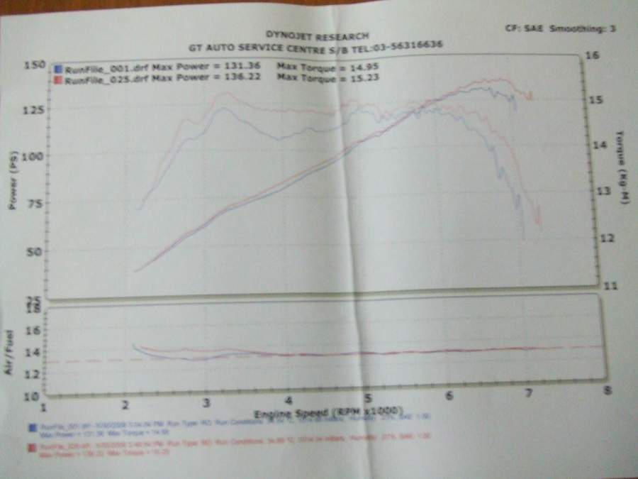

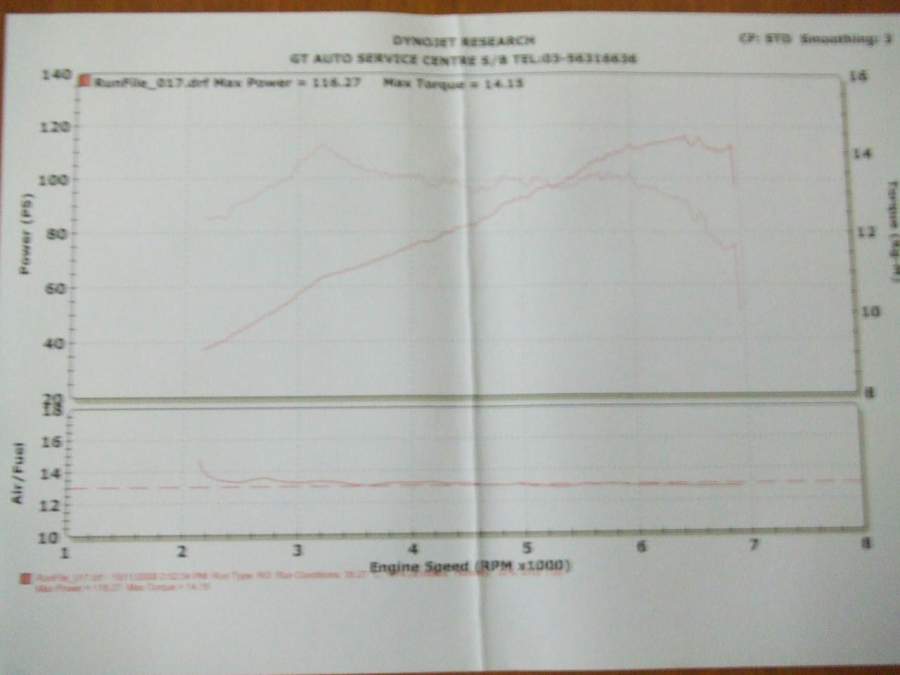

helo all, i'm using 4g93 n/a engine with slight mods & recently dynoed my car and noticed that my hp had gone down from 136hp to only 116hp. can anyone diagnose my engine's problem as from the dyno result the a/f ratio was the same as before. thanx in advance.
dyno done at same shop..

if u did both dyno's on the same machine , GT Auto , then you have indeed
benchmarked before and after on it, it should yield best comparison
it really shows ur car has dropped power , reasons power drop could happen is
1. lost of engine compression caused by pistons rings or valve seals & etc
2. dirty sensors which changes a/f ratio
3. tuning disturbed
looks like your a/f is a bit different ...
has it been re-tune? look carefully at the A/F ... and it has a slight different ...
maybe the 1st dyno was when u newly seviced the car ... the later is due already :P
that what happened to mine ... a slight drop ....
3. tuning disturbed

thanx for ur comments guys, i've also been suspecting that my adjustable campulley marking sudah lari bcoz replaced my head gasket b4 the 2nd dyno. So izzit logically explained that my 20hp horsepower drop is caused by timing marking lari?
I don't think adj cam gear can drop u for 20hp...even with hi cam!!!
How bout the others guys?
any comment?
i think in can be because of the distributor and the campulley...16hp drop for my case....u can retune your car to achieve it back...no problem...
well.... hi cam + correct afr setting can gain +-20 horses, if the setting run, the power gain goes back to normal cam bench mark i guess.... mebbe this is what happened.... really luv to wait for experts comments...
i've checked my compression ratio and all cylinder is ok giving average of 11 compression ratio, except my cylinder no 1 (nearest to the timing belt) is 9-10 compression ratio, which i was told is normal for an old engine.. hmm i guess i have to send my car again for dyno tuning to find out whether can get back my 20hp except there is other explaination can clarify the loss.. bcoz i'm scared that even after another dyno tuning the hp will still remain the same as before which will cost me $$$ even without gaining back my horses..
