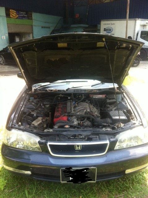

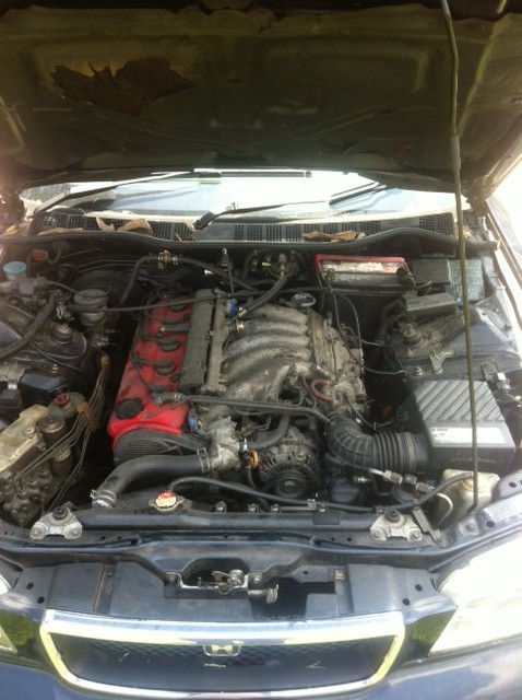

i have Honda Inspire UA2 bought from Nigeria Diplomatic year 1997
the model import direct from Japan 1996
the problem is my car engine was damage, i want to convert my car engine...
so what the engine suit for my car?
the cost
and the workshop can do it
h22a
f22b

my car is FRONT wheel drive... so can if i want change to engine accord sv4?

sorry about the confusion. i thought it was rear wheel driven. if front wheel you can choose H22A from accord sv4 or F20B from CL1. both is vtec but you will lose some torque compared to your stock engine. engine mounting also will be an issue. and yes, F22C engine can fit your car since your current engine layout if MF layout, of course by retaining the stock tranny. perhaps.

i've already found some foreman and workshop to solve my problem.. and some of them told me that the problem is the frame and the mounting if i want to convert to F22B engine from Accord SV4.. they will try to find the solution and try modify the mounting and frame with custom made.. hope they will solve my problem and if you have any suggestion please reply me.. thanks
very rare models...looks like rear wheel drive?5 pistons?cc?
front wheel driven bro.. MF layout.. try google on wikipedia.. i also confused before. :rofl:
don't use F22B from sv4.. quite underpower.. H22A or F20B from CL1/4 will do.. F and H series block shares most of the parts and mounting position. glad to hear that. kindly update us the progress.. :)
