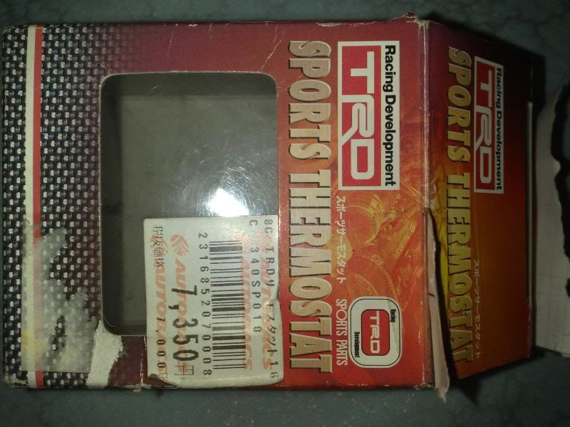

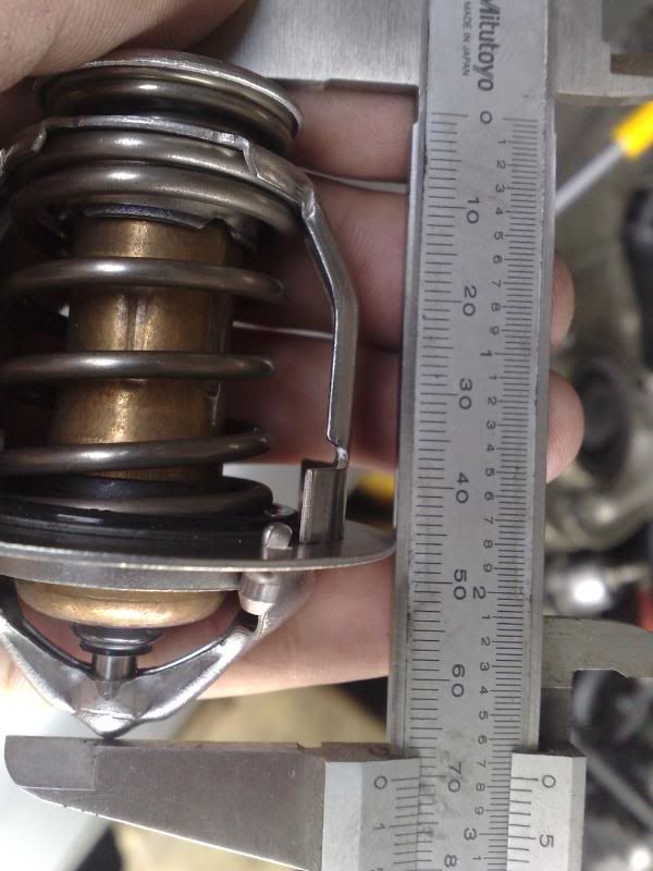

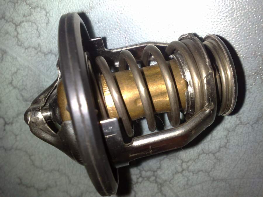

I bought a thermostat last year from a seller here who's actively selling parts but didn't reply to my queries. I may have been my fault due to it being a long time but to my defense, I asked him many times if it could/would fit for my car since I'm not a mech and I don't know how it looks like exactly. He replied assuring that it was meant for a 4age 20V SVT.
The reason why I took a long time to install was I thought I'd do everything at one go. ie; change radiator, silicone hoses & water temp. But when I tried to fit in the thermostat, it was totally different from the stock one.
I have NO IDEA which thermostat is this for and am seeking someone to let me know so that I can sell it off cheap! cheap! :proud:

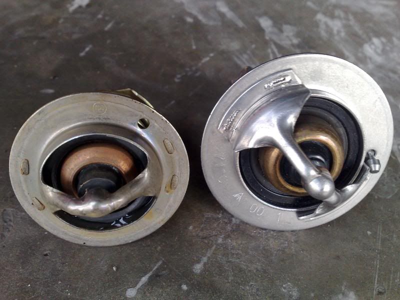

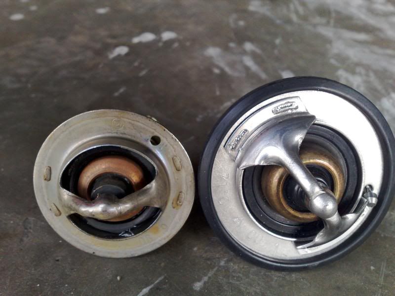

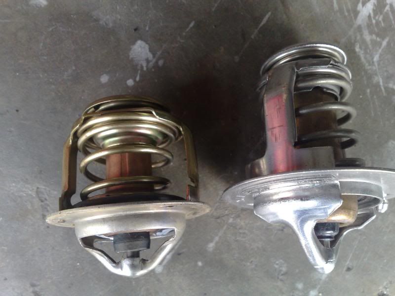

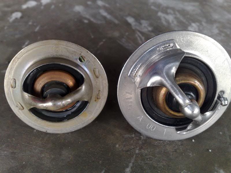

Left is stock 4age svt..right is the one i bought...

Hi bro,
The thermostat you buy is for 4AGE 20V BLACKTOP only, also suits other 3-S SW20. Many people
didn`t realize that 20V silvertop housing is smaller than blacktop.
So you need to get 4AGE 16V thermostat instead of 20V.
Hope that helps :)

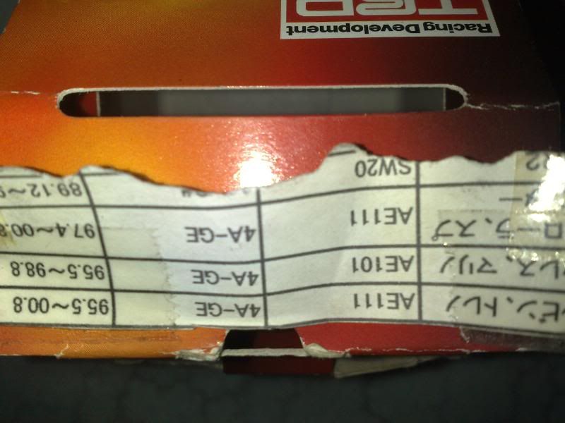

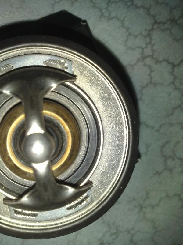

The TRD thermostat didn't wrote any TRD word on it, but it got wrote the code on it.
Hope that helps :)

Found this that had both part numbers..
http://www.tunemytoyota.com/forum/showthread.php?t=2715

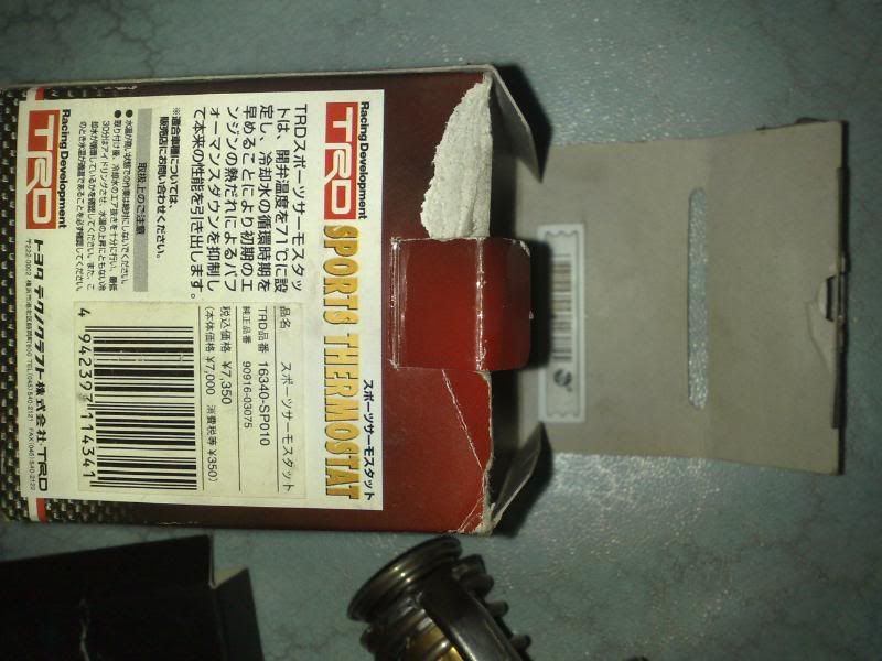

Blacktop Thermostat: 90916-03075
Silvertop Thermostat: 90916-03060

Should be the same for 16V RW/FW, since it`s also suits FW 4A-FE. You can bring current thermostat and compare~heee

Yeah saw that stated for both AE111, need to inquiry direct to knw which engine. This is what from TRD :
http://www.trdparts.jp/english/parts_thermostat.html
AE101 for 4AFE engine, AE111 for 4AGE , AE11# for 4AFE

Funny that it doesn't have for the part no. 90916-03090
Adapted No. TRD Part No. Code Toyota Genuine Part No. List Price(JPY)
1 16340-SP000 C 90916-03046 7,300
2 16340-SP010 C 90916-03075 7,000
3 16340-SP020 C 90916-03093/90916-03126 8,000
4 16340-SP030 C 90916-03100 8,500
5 16340-SP040 C 90916-03122 Discontinued
6 16340-SP050 C 90916-03084/90916-03125 7,000
7 16340-SP060 C 90916-03120 Discontinued
