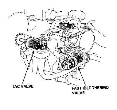

FITV is the located under the throttle body as per the picture.

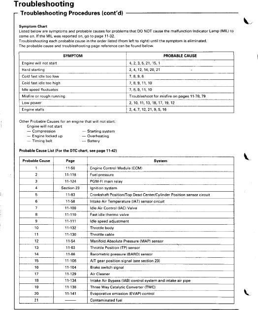

Here's a troubleshooting guide.
Just a quick check on the FITV. before the throttle body flapper. There's a small hole there which is operated by the FITV. You'll feel a slight vaccuum there on the small hole. Try blocking it with your finger and ask someone to play around with the throttle and see if the same problem persists.
