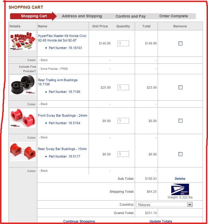

i've mailed them before and attached are the quotations for the hyperflex master kit + front way bar + rear sway bar + trailing arm bushings. total converted to MYR is about RM804 including shipping. but after what you've said i might not be ordering the trailing arm bushings, so the price will be lower. oh, will there be any tax that we have to pay if we order online?

If post office asks you to collect, there may be tax, (auto parts tax) based on invoice. At least that's what I've been told...I've never ordered directly to Malaysia before...
