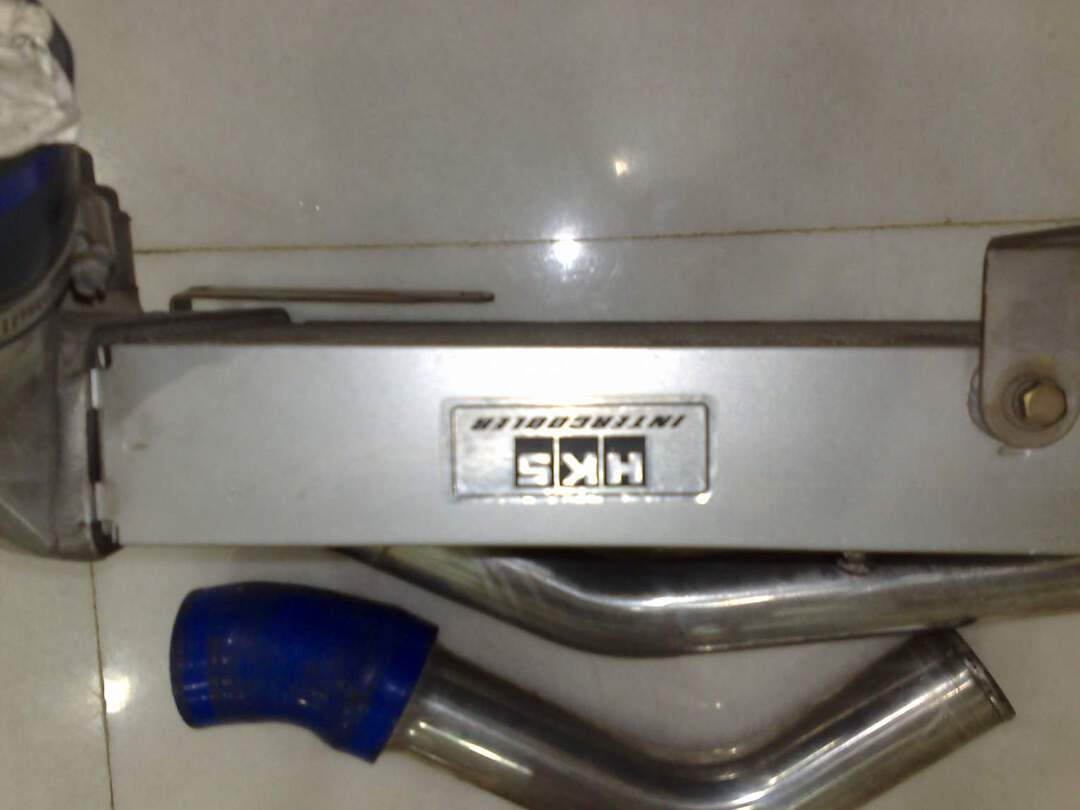

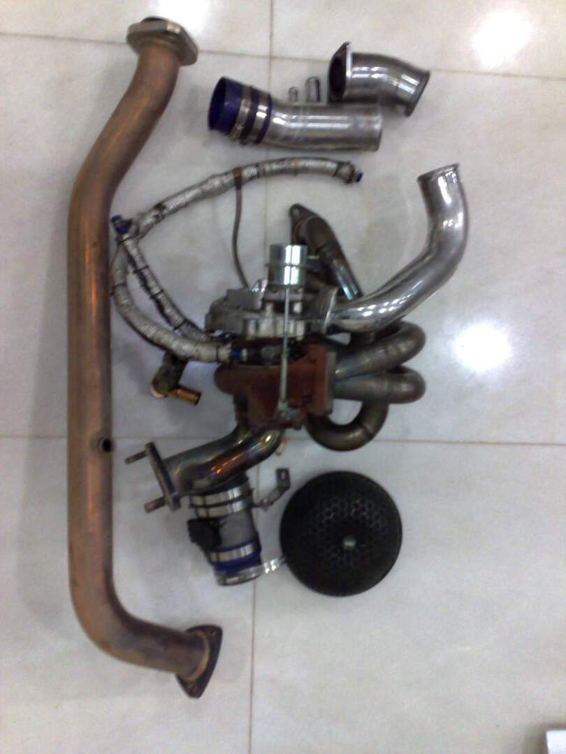

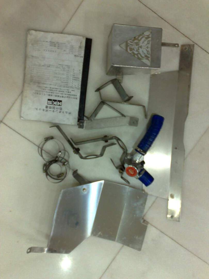

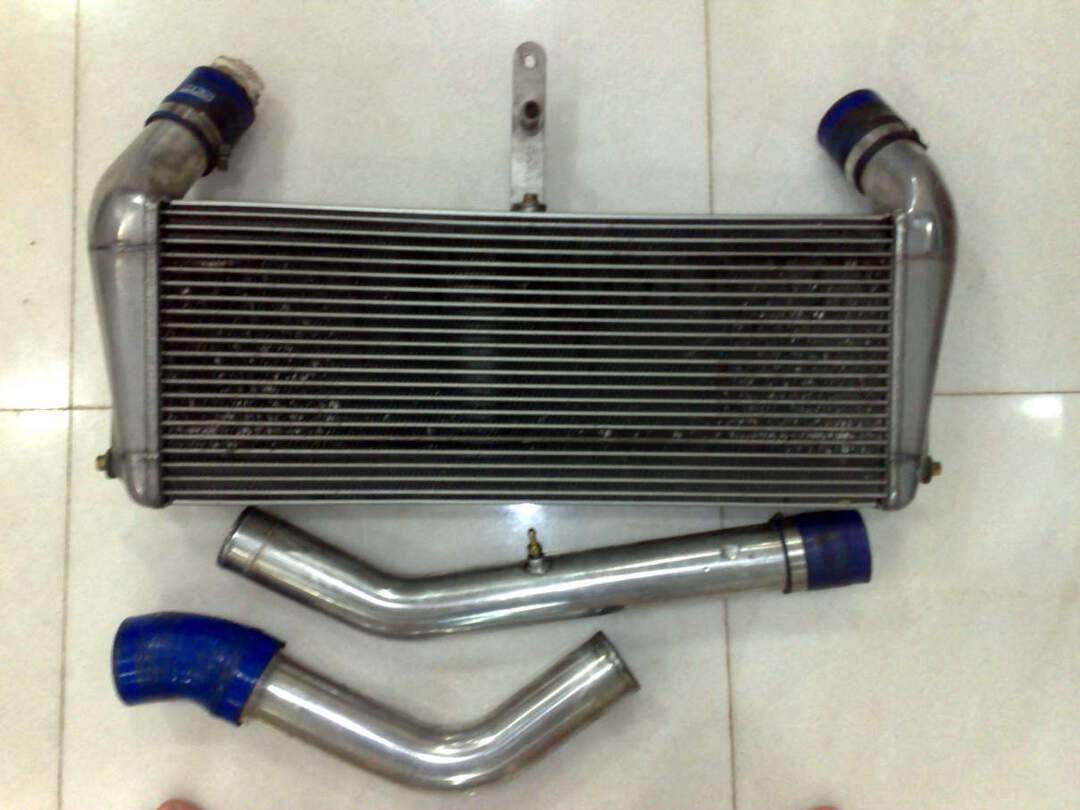

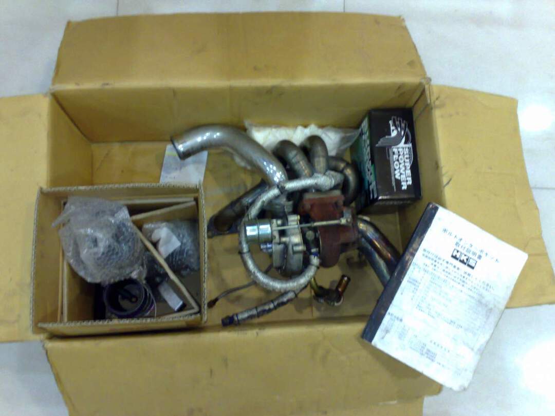

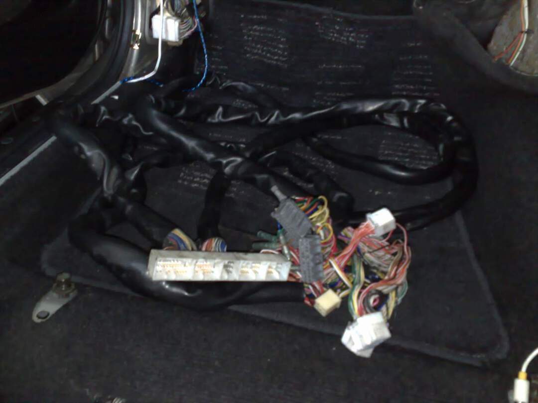

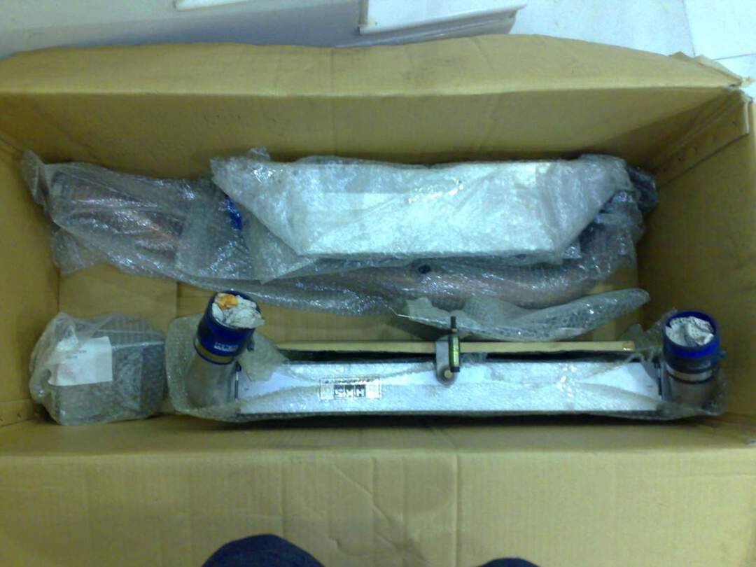

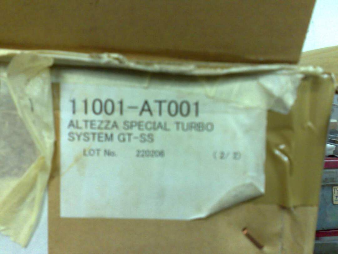

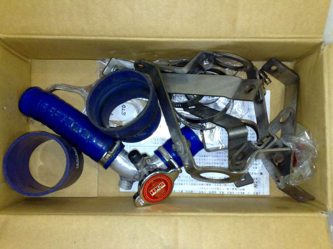

How many Kits are there in the market?Pls Share if u have information.I can only share you with what i have and taken out from my car.HKS GT-SS Power produce is 320Hp on engine with standard internals and 0.6bar.HKS have another kit called HKS GT-RS that pumps out 370HP on engine with minor internal upgrades. GT-SS & GT-RS basically are the same with just interchanging of the TURBOS.GT-SS brand new = 698,000 yenGT-RS brand new = 760,000 yen (if i remember correctly)So cut the crap & look at the pictures what the kits consist of.
