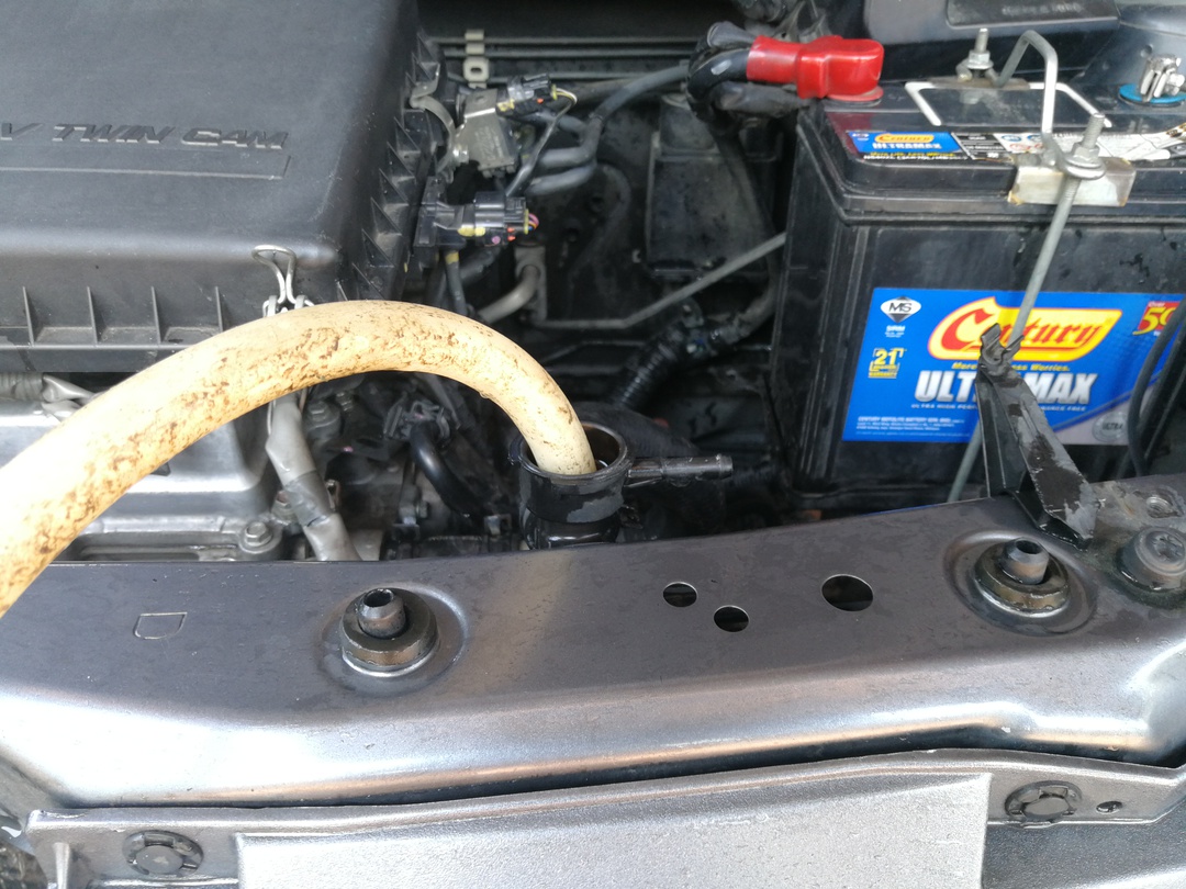

Flush radiator with coke (Paging MADMAN)
Got to let some amount of water out first
Yea, I let the water out, I was considering using back the same water but found out the water was a little bit brownish. I think it's from the coke although I tried to make sure all the coke is out of the system lol. Should have use white vinegar, NSK selling them for cheap. Overall, I learnt quite alot from just flushing the cooling system of the car.
This discovery alone considered a plus already. Sudah untung

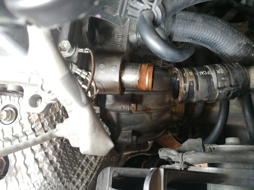

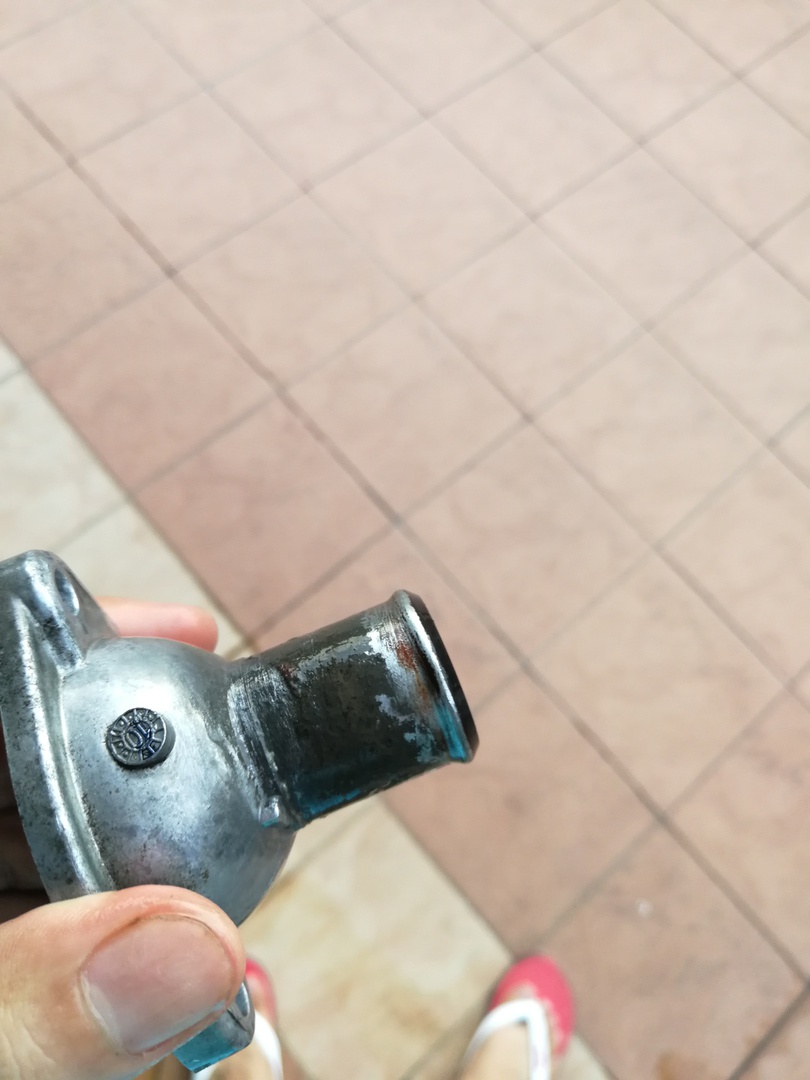

I also found that my old thermostat is still working , I'll just keep that as a spare and use a new one.
Photos incoming

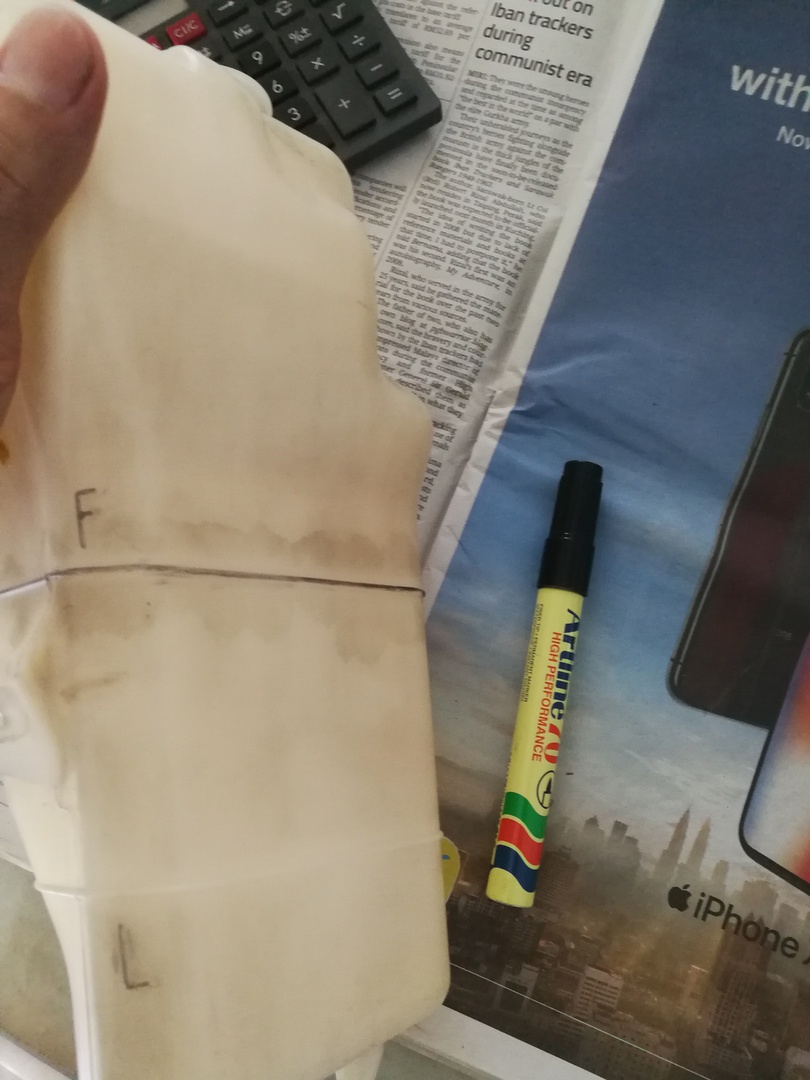

I did use the distilled water two days, flushed out some brown water, smelled like coke. I think based on my observation should be okay. Hmmm, if few days down the road I see some particles in the reserve tank then that means I didn't flush properly . But hopefully not lar.

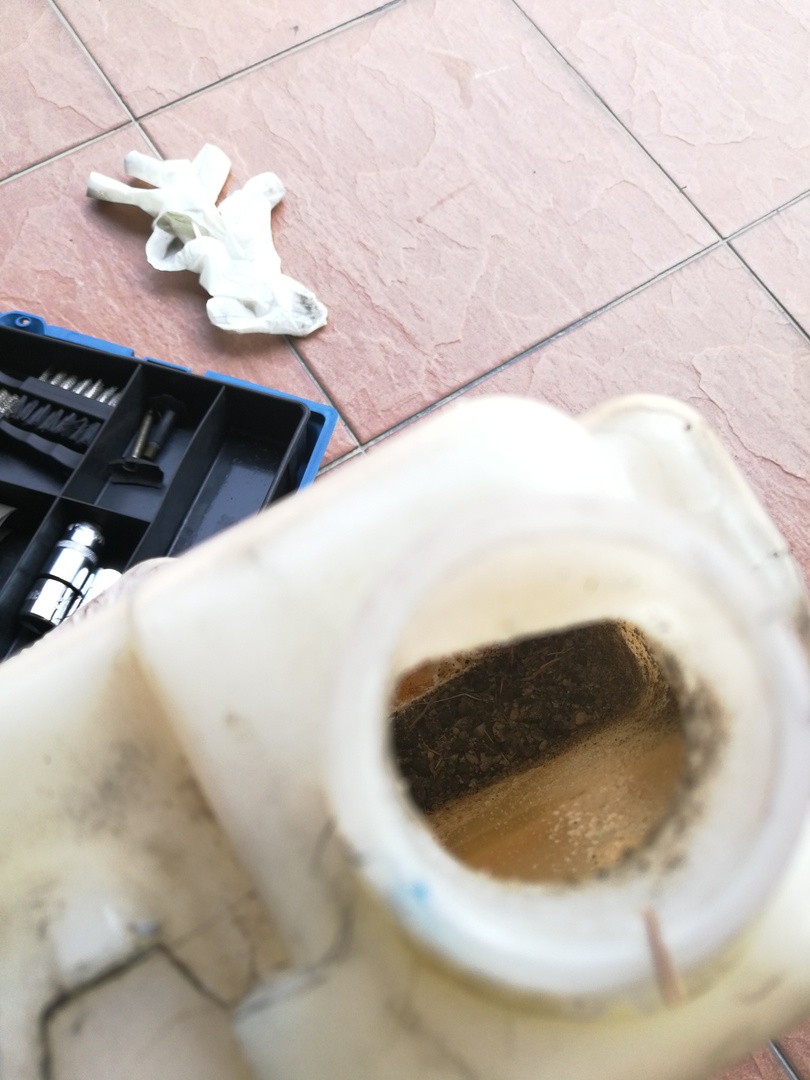

LOL, the pebbles i sweep from the front porch to be mixed with detergent into the reserve tank.

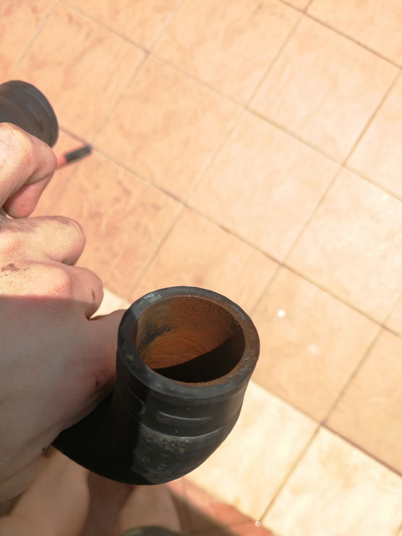

I actually got some more pictures of cleaning the radiator hose rust but each posts only can fit 10 pictures, dont wanna spam this forum.

Kevin, what's with the pic of the pebbles. Dont tell me those came out from the engine
