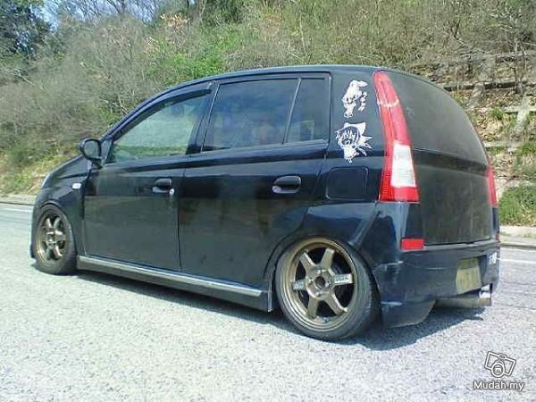

anyone knows the tyre size for this?
my guess is 195/50/15..
i wanna achieve the similar look to this :)
Its more like 195/45/15, 50 is fatter. Have friend use 15 on kelisa b4, he use falken 195/45/15 fit well..
