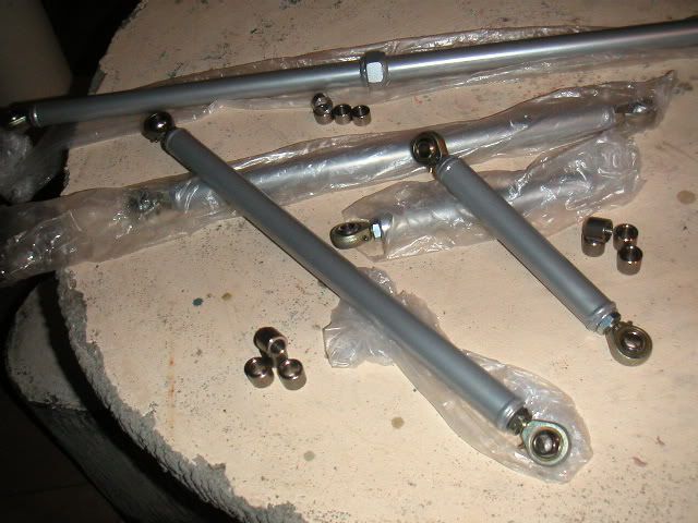

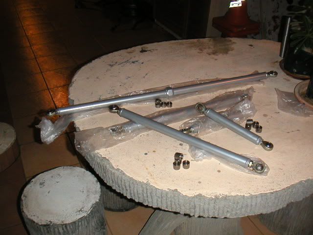

here's some pics of the Panhard Rods i made.
it's powder epoxy-coated silver.
material specs:
tubing:
carbon-steel SEAMLESS tube, 1" OD, 2.3mm thick. (OE spec)
threaded ends:
machined mild steel, M12 x 1.5 threads, MiG-welded to tubing.
finishing:
lathe machined, finished with epoxy-powder coated. (silver)

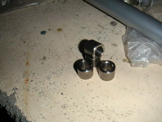

comes with stainless steel (for durablity) collars.

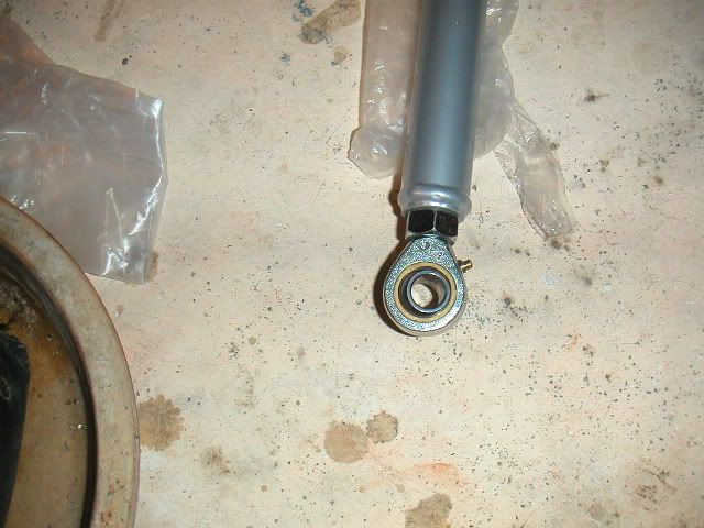

joins are ROD-ends, or Rose-joints. Panhard rods has one left-thread and right thread for easy adjustments.
4 links are all right threads.

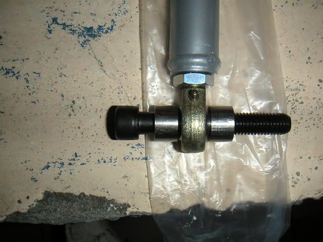

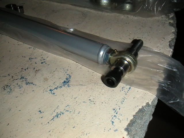

this is how the rod-ends with the stainless steel collars will look like assembled, under your car.
components like the rod-ends are 100% replaceable, just make sure spec is same.
i'm making these for sale, and retail is RM300 per rod. (length doesn't make much difference!)
please PM me for order or for viewing.
