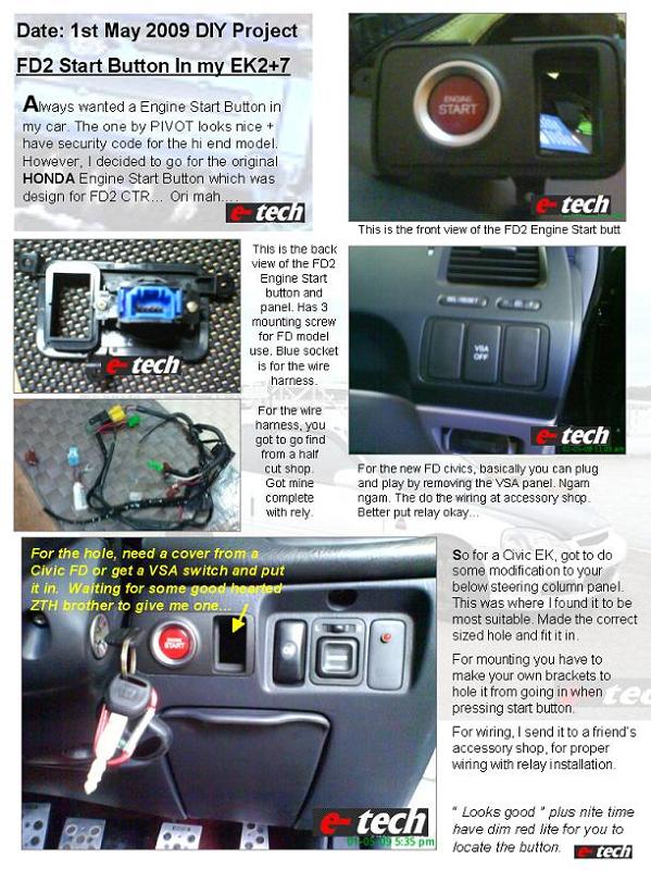

Read the thread by guangek9 selling FD2 engine start button reminded me of the DIY for start engine.. FD2--> EK. Hope you like it..

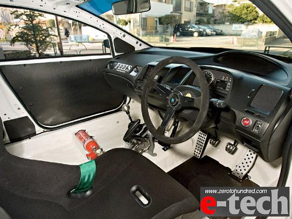

So, anyone got spare cover for the hole beside the start button?
Or should i just put in a piece of cf sheet with a switch??
http://www.zerotohundred.com/newforums/albumpics/thumbnails/3/1b0004b7acc23e8b4bfce9dfb11dc8b3_3934.jpg?dl=1257517833
