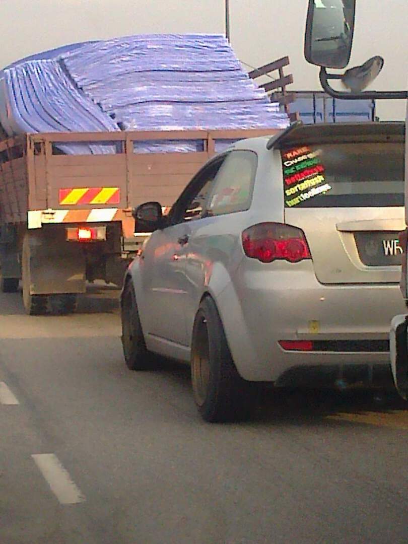

I stumbled across this phenomena recently....don't know whats their point of having oversized rims till poked out of the fender arch....wider the track the stable it is I believe to them...many of them comes with 'Marshall' and those round2 sticker too LOL :adore:

seen the owner before.....is an arab guy if not mistaken, saw the car few times at sunway area...

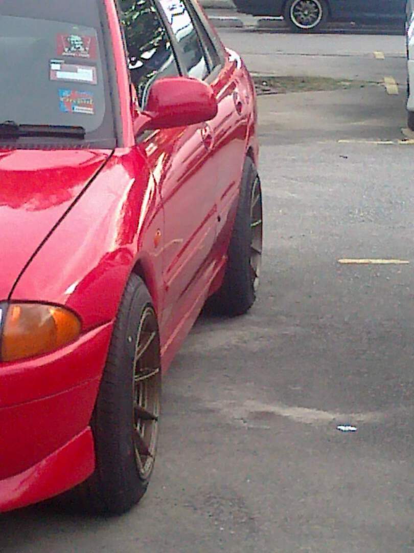

Depends on the offset, if offset is further out won't hit inner side and again unless very wide tyres....
hehe... i blame hipari, hellaflush, stance nation , i heart stance, stance works.....
if japan oldskool + olskool rim (SSR) = OK
if eure oldskool + olskool rim (BBS) = OK
if wira/satria + taiwan rim (offset +30) = funny....
*now alot of taiwan rim with low offset in mudah, and cheap also...
*wider rim (9J) does NOT means wider tyre, maybe just normal tyre (195 or 205) stretch till max....
