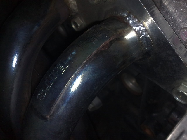

sorry, but i need advise regarding my exhaust system...
my hotbits 3-1 extractor for my viva cracked!installed in 2009.
now i am not sure what to do...
im broke at the moment to replace the extractor wif a new one.
and if i do replace it...i m still not sure how long the new extractor can hold up.
all exhaust shop i went last weekend refuse to weld it back and req me to buy a new one instead.
those shop said that SS is prone to crack over the years...
well i used SS extractor on my other cars but not HB brand...it last until today...
how bad is the crack?
i cannot take pic...coz its too sempit..
however pls refer to below pic for further understanding...
it crack around the welding part...i notice two of it has been affected...
if thats the case i tink rewelding the welded area shud be good enough for the fix... IMO of course...
it should not interfere the flow of the gasses to weld it back... a man with good metal crafting should do the job... just clear the old weldings den reweld the thing... best with TIG weld...
but wan easy... just simply weld of the crack sudah boleh lah... a quick fix
