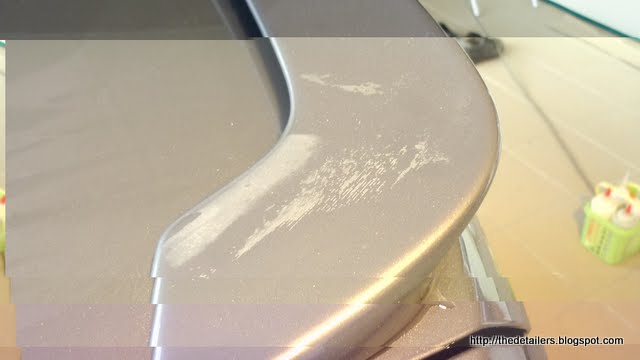

picture of the damage spoiler, BEFORE
Restore Picture
Extreme close up pic before correction

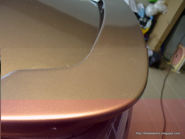

Picture after corrections, matrix picture…
Hope was restores…but that 1 foot of correction took me nearly 2 hours to restores . The most delicate detail I ever attempt thus far.
