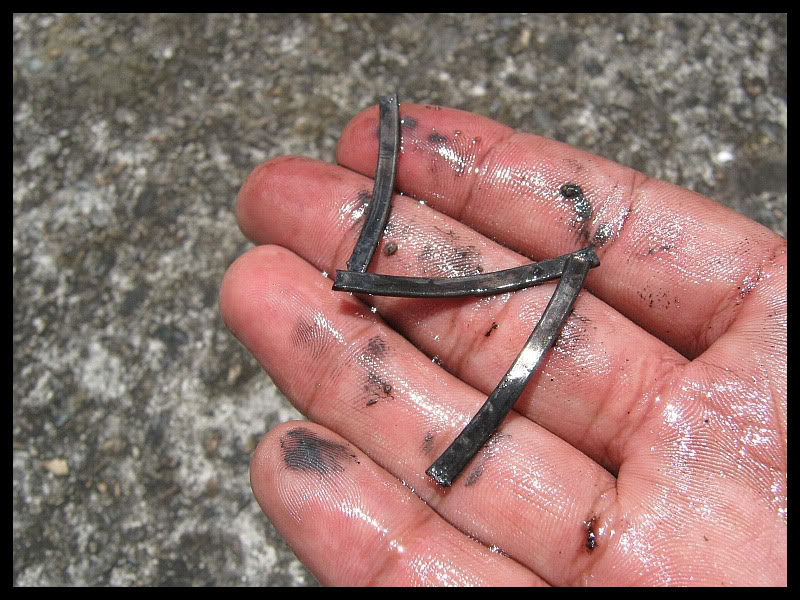

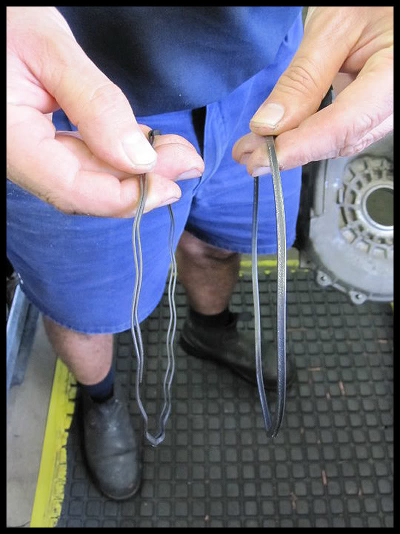

Added few e7gta australian to share some experience and info.. such as gearbox weakness and overhaul it with what kit or compatible part.
This autobox is fragile.. mitsubishi knew the problem and didn't recall all the units when selling in Japan.. gearbox needs to be rebuild/overhaul even its for stock power.. if anyone hasn't break yet.. u r lucky or that broken spring shave just hit filter. .. .. or i'm daily driver which is aggressive driving style? XD
GTA gearbox is the same as Airtrek's. So far almost 5 years now for me, my 2003 Airtrek is running strong without any gearbox problem. I have basic modifications like full exhaust, TD05 from Evo 7, FMIC (AIrtrek uses TMIC), cams etc etc.
same but GTA inside wave spring much weaker and some other part need to be upgrade
i took many photo. Shared in evolutionnet.
overhauled it with airtrek auto box kits too..
the pic u can see why.. ah wah there oso know this..
