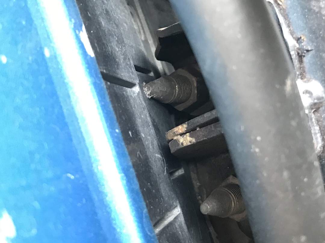

So out of nowhere I happen to find out that my civic engine mount bracket (the one of the right side when we look at the engine) happen to break.. something that’s usually the opposite where the mounts break and the brackets stay solid.. what’s bothering me the most is the fact that I still fear of driving it and I only get to start the car everyday (typical me).. still not too sure how to solve this problem liao since I’ve been advised to change the mounts as well (which look good to me cause the rubber also no sign of crack).. and I need to find the route cost to this issue.. plus is it possible to diy this because paying 700 for a 300 job is kind of :confused::confused:

So one way is to weld it back? Noted.. need to find a shop that’ll do welding liao.. and yes as confirmed it is the bracket because the mounting screws (Picture attached) is literally scrapping almost the hell out of my block.. mounts seem fine to me

However, your pic showed the engine i
has moved quite a bit. I am guessing +- 2inches and thats a lot. Other mounting might be stressed to the point they are damaged too.
