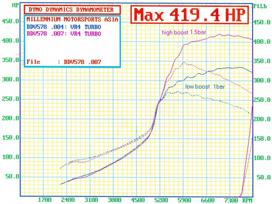

Wira VR4 engine
1.Stock engine with overbore 86mm pistons
2.Microtech LT10s
3.Injectors 1000cc
4.Turbo Garret GT30
5.264 deg Cam
6.Stock gearbox evo3
7.Turbosmart boost controller
Low boost 16psi
Good torque.

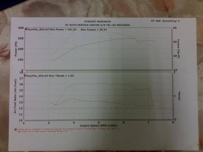

drax chip ecu+ td05 + 4g63t + 1.4bar gave me 301whp
after microtech and 20g , 346whp , tuned by abg penang (waiting for free time to go to toby/thomas for reprint)
currenty 0hp :P car no engine kekekekke
