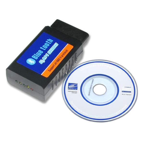

Hi All,
I just bought car diagnostic a China made ELM327USB and ELM327bluetooth , however was unable to get the software to connect. Tried Proscan, PCMSCAN, DIGIMOTO , OBD-DIAG , SCANTOOL and a number of other software, none worked....I tried many car Waja, Satria Neo, Myvi, Perdana V6 and other car.
Anybody around KL willing to help me to install & configure, I'LL GIVE TOKEN/REWARD TO WHOM CAN SOLVE THIS PROBLEM. by the way, driving a waja and Perdana V6
Pls call me at 019-2499965 or email [email protected] (URGENT)
Proscan , Digimoto, PCMSCAN manage to :
1. Open serial port - OK
2. Detect interface - OK
3. Initialize interface - OK
4. Initializt OBD II - Failed
Believe the communication from PC to OBD II converter (ELM327) was successful, however, from ELM327 to car OBD failed... have tried different protocol still no luck ,

Hi,
I've not used ELM but it should be able to read ODB2 protocol.
Have you set the ELM to read protocol 3?
Neo is using ISO9141-2 protocol and so does most of the
other Japanese OBD2 equipped cars. Try those settings
and see what it response.
When using scanners, we have to set the protocol that is
compatible to be able to communicate between the scanner
and the ecu. Otherwise it just cease function.
