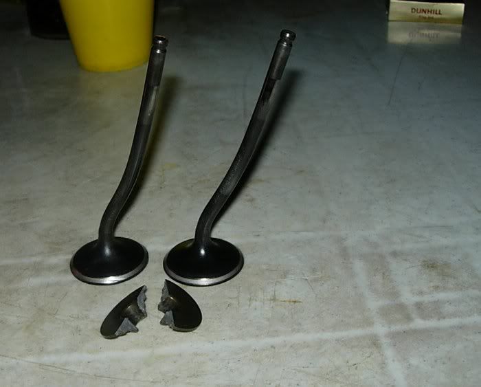

last time ur retainer broke into 2 is stock type r retainer or ti-retainer?
hattech-v said:last time ur retainer broke into 2 is stock type r retainer or ti-retainer?
Oderf said:yeah...u shud be worry about that....that shows ur engine is running on a relatively low compression bro.....if high compression sure knocking one if u advance ur base timing too much........i aso wonder about this before since my car aso behave that way....max advance still no knocking....dem!

udengfahlawi said:how do u know if the retainer is about to fail?...any signs or way to check kah?...
J101 said:to be honest, for maximum usage for retainers, valves and valves springs, the lifetime for it is actually 40-50,000km. that includes aftermarket eventho their titanium. dont get me wrong, i know driving an old 14year old b16a engine is A-OK but you would get the best out of it in the long run as wear and tear contibutes all the time.
hattech-v said:but i've checked the compression and all 4 cylinders show the same result.
its 230psi if not mistaken.
Oderf said:230psi equal to what ? 11:1 ? aiyyaaa.... then must be something wrong somewhere.....let me know when u find it out...confusing now ....:Not_Impressed:
