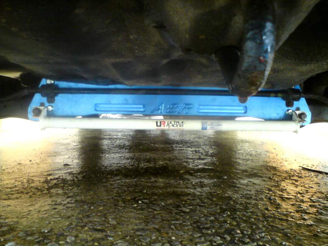

sifu madman, now i installed the ASR, understand the concept of it, no nid drill, ori civic got all the holes, just honda use a metal plate and screw it to cover it, but i just realize and think that the ASR make the force disperse to the alloy bracket more then on the bling bling brace...lol
if u install the ARB, then the force of the ARB will be distributed around the brace before actually going to the bracket...

i think is replica,i got it for rm300:biggrin: but replica not good enough?:confused:

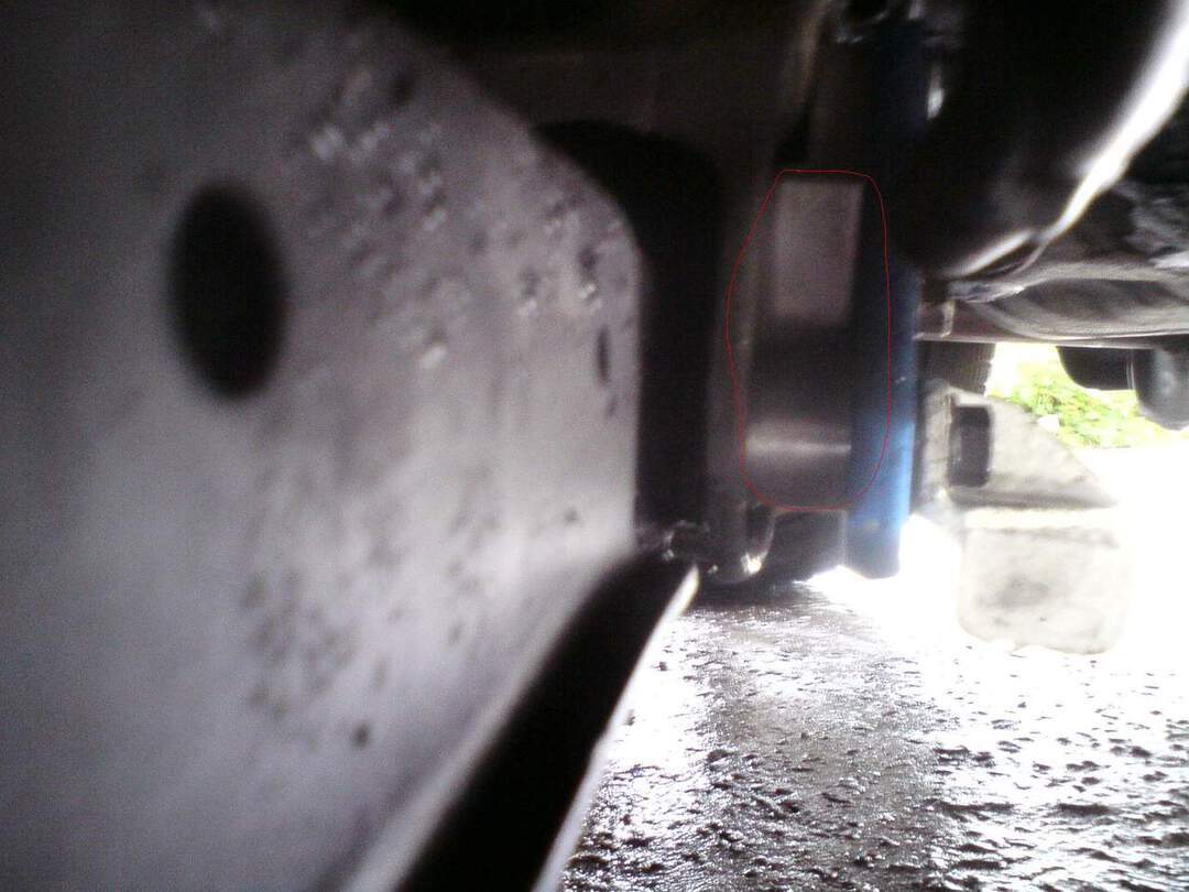

note that i changed the lower arm bolt to longer 1 since added thickness (white circle),and i jack a bit the ARB bracket to fit cause my car so bad, the cross member ada lari sikit,so the holes not accurately in position....
take look at the picture, red circle, what i mean is the bracket (shiny alloy) is in between the car's cross member and the ASR brace, make me feel like the force more on the bracket and the ori cross member then on the brace.........it just like a washer in between the brace and the cross member.... lol

and get rid of the UR tie bar la... already pasang the ASR, the tie bar becomes useless.... adds unnecessary weight really spoils the look

u sure it become useless dy??:confused::confused: and , what big diff between ori and imitation?:confused: and bro madman u use ori?
theory wise, both works the same. strengthening the same points, as they bolt the same points. but material of the two may be different?
again, theory wise, i think both has the same function... open for debate.. i am no engineer.
my failing engineering theory is (i am just engineering student), more bar ,or thicker bar will make it strengthen more, does it will?? lol:biggrin::biggrin:
and for the weight issue, the ASR is twice or 3 times heavier then the UR bar since it is thick, i am not so worry of adding more weight at the rear since i removed spare tyre at the rear,lol
i am more worry on the diff between ori and imitation , and also the problem of the UR bar always hit by stone..lol

and also, i agree the ASR will strengthen more then the UR since UR just 2 bolt at 2 point, but the ASR had 2 bolts each sides to hold together on the cross member and it is thicker and more surface covered
ohhh shit, u asking abt the tie bar is it? i thought u were comparing the ori ASR subframe with the immitation one.
i THINK (not an engineer) what madman said its true, but what u said is also true. i had this discussiom with my foremen. he used the metal bar from inside an EG door, those "roll cage" type piping inside our doors, he cut it out and welded it to the chassis, below the ASR subframe, or rather, in between the subframe. i quote him "stiffer is of course better, but if its too stiff, he may suffer oversteer"
not my words. just quoting. open for discussion
i am asking both the tie bar and the diff between ASR ori and imi... but from what i think, the imi might be same stiffness or weak a bit then the ori, sometimes, from what i compare the imi and ori stuff, for metal or alloy stuff, ori tend to have better performance and but lighter weight then imi since the material used is better and lighter,can see it from the price.....

diff between ori and imitation is basically the build quality...finishing... not sure about the brace itself, but if u look at the ori vs fake comparison u can see that the bolts are oso of different strengths.... but basically, both works the same.. i oso using the replica...
as for the tie bar...it becomes useless coz ur supposed to mount it on the subframe itself, to ensure the 2 points of the subrframe dont flex... but u put the ASR there... it already does the same thing..and it does it better as it has more mounting points... also., the tie bar will be mounted ON the ASR.. which is pretty pointless....lose ground clearance somemore (especially with beaks tie bars)....
