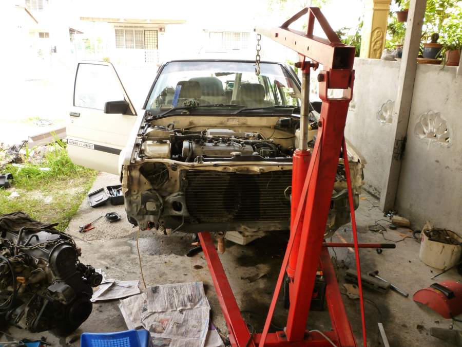

these some pictures for who want to see lah. ONLY ONE PIC CAN UPLOAD. I DONT KNOW WHY.

wah edra,just curious if ur DIY project disturbing ur neighbour..
looks like in front of ur parkin area..
atau u dh kowtim baik-baik dgn jiran..hhe
blackend...why should i disturb my neigbour. i just use manual spanar not use compressor even i have it. quiet and safe. cuma lambat sikit la. yesterday i had to spend my money for wireman for rm120 for rewiring the main wire becoz when i bought that engine many wires and connector missing. i tried to fix it before for 2 days but cannot solve. i respected to this wireman becoz his wiring very nice n clean. he using iron sleeve and wire sleeve to clamp the wire instead mine only using black tape. now my engine succesfully started. :adore::proud::burnout:
