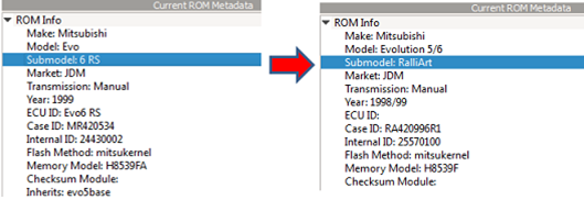

1) ROM/Program change from stock to ralliart
attachment.php

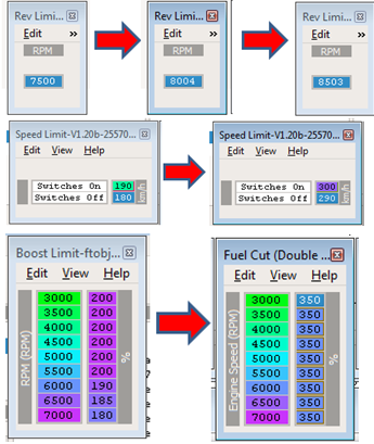

2) SPEED/REV/FUEL CUT REMOVAL/INCREASE
attachment.php

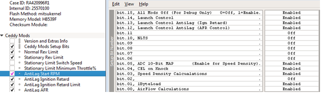

3) LAUNCH CONTROL/ANTILAG -
TESTED refer youtube video here--> https://youtu.be/uicb0FnblaM
attachment.php

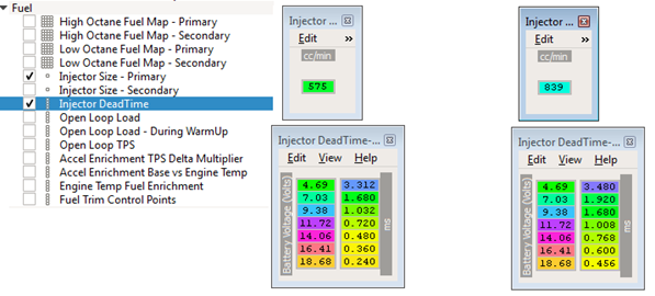

4) Large Injector Tuning/Scaling
attachment.php

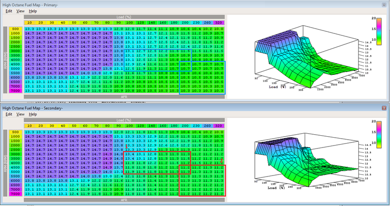

5) Air Fuel Ratio Map Tuning
We use AEM UEGO Wideband connectod to serial cable and computer for data logging vs load/rpm/ignitio/knock and all parameter
#Evo Stock Mapping(refer primary) running very rich at WOT ~ 10.5AFR (box /graph area) ,by tuning to safe AFR at WOT ~11.5 wil yield higher whp/torque
#AFR tuning/check is done via Wideband
attachment.php

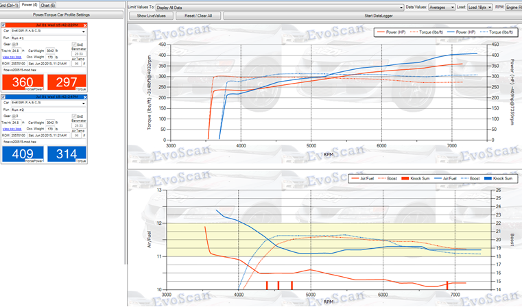

6) On The Road Tuning
By leaning the AFR from 10~11 to 11~11.5 at WOT hp improves through out the rpm,
Eliminating knock at peak boost and high rpm via ignition timing tuning
Final WHP from 360 to 409whp(+49 whp!) Torque also increases from 297 to 314 (lb/ft)
attachment.php
