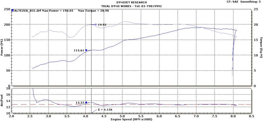

Due to long time dint update from TRIAL, today we have jus done the tuning for altezza track car with power fc. (horse power 190ps ; torque 20.98kg-m)

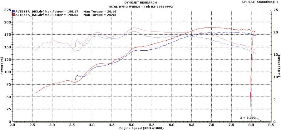

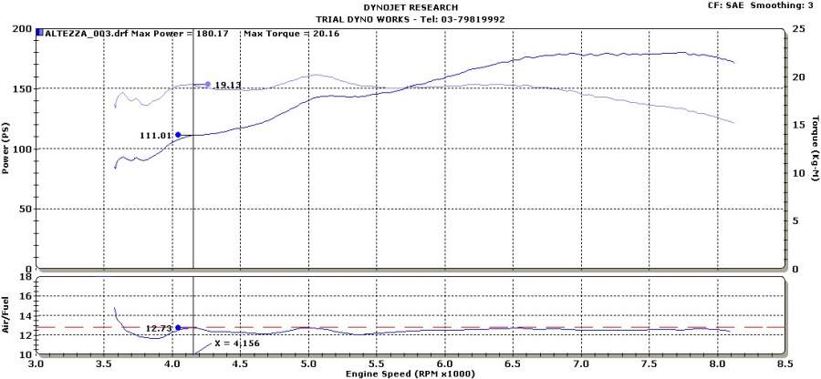

Here is the comparison of TRD ECU (Altezza one make race) and Power FC (Tuned By TRIAL).
TRD- horse power 180ps ; torque 20.16kg-m
Power FC - horse power 190ps ; torque 20.98kg-m
Note: There is no other modification have done on the engine, just the ECU.
Below is the dyno graph for the altezza track car.

internal stock due to netz cup regulation but engine is balanced. The engine still remain the same. But there will be a new engine with toda's stuff inside on june:biggrin:. Gearbox and final is also stock.
Actually just want to proof wat is the max power of this stock engine.
what i found is:
1. stock internal + power fc max 183ps ( in 1 of our taiko car )
2. stock engine + balanced + power fc max 190ps
i will also add a comparison dyno results between Civic type R FD2 later.
