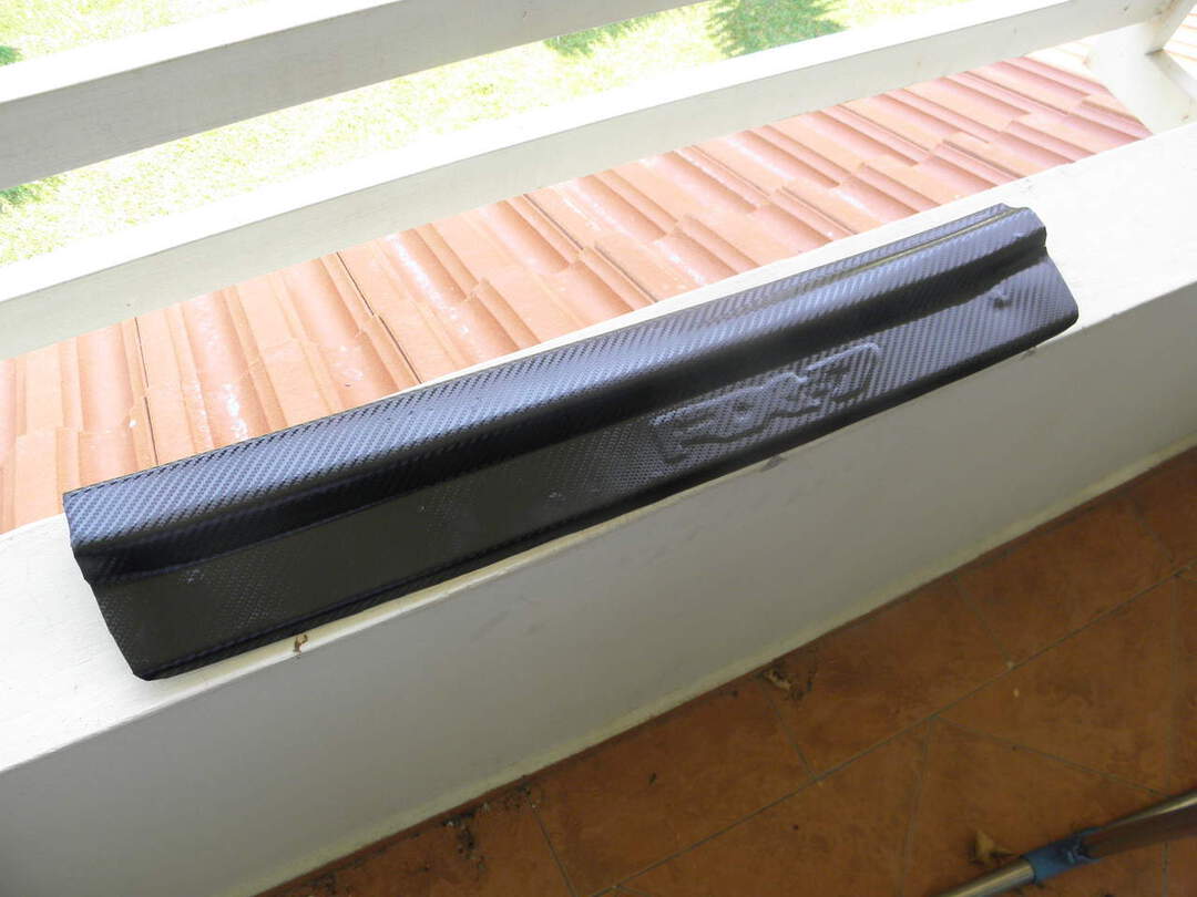

just to share with you my self-made carbon fibre side step for fd.. ha ha.

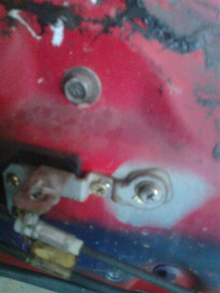

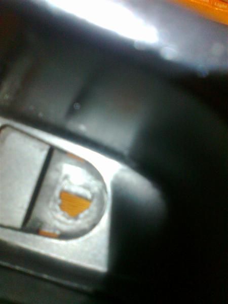

this the late pic of how to strengtern the inner door handle,, 1st pic has the inner door cup strengterned with metal plate at the friction area.. i drilled it to become bigger hole to allow the screw to go thru. 2nd pic has additional screw into the part of metal very close to the pulling part.. i also had to make a little drill..

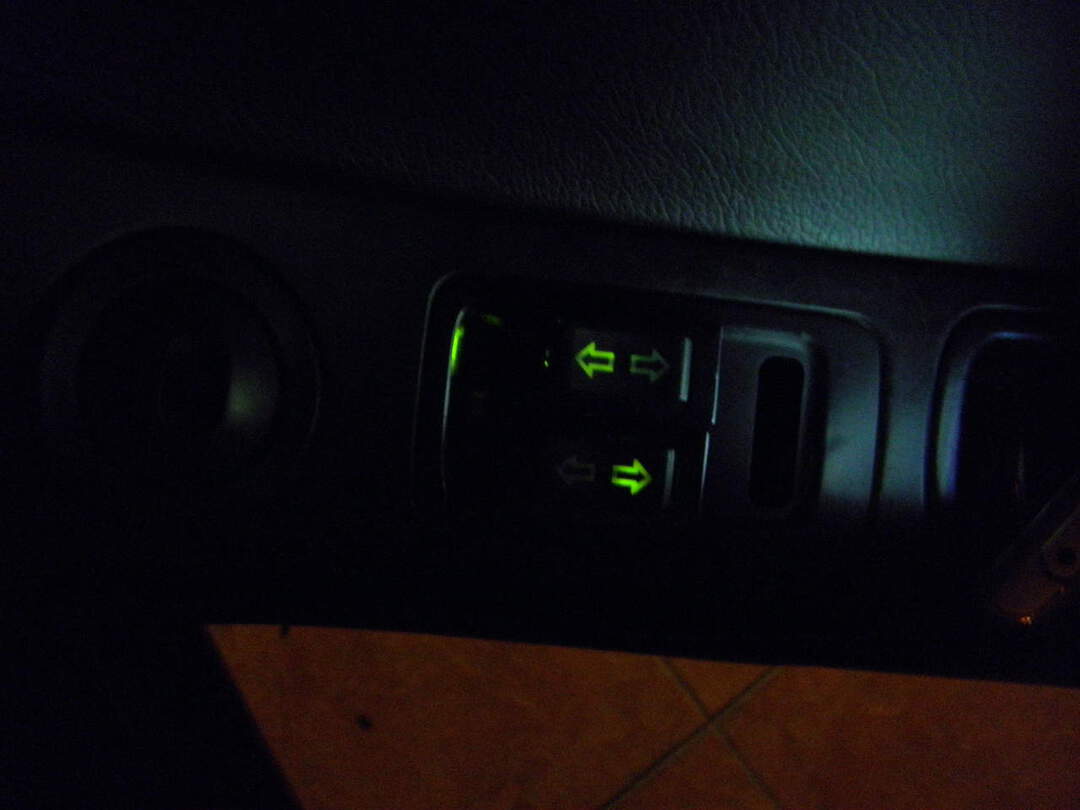

due to shortage of parts,, started this project for modifying master power window switch,, due to poor response towards the previous posting ,, i would make long story short,, connect the wire (easy la plus minors electric points bla bla) then make bigger hole or reduce size of switch then voala,, ready..
if you think it is easy it is because you havent tried it hands on till whole biji(assembly) is produced.. if you need more info could pm me.. welcomed.
