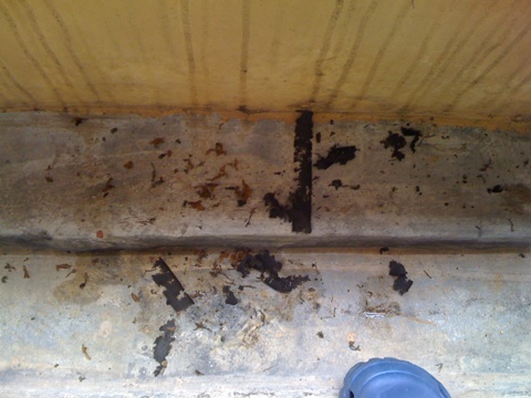

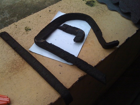

Removed the old sponge. Make sure the surface is clean.
attachment.php
Old sponges which were brittle and dropping off.

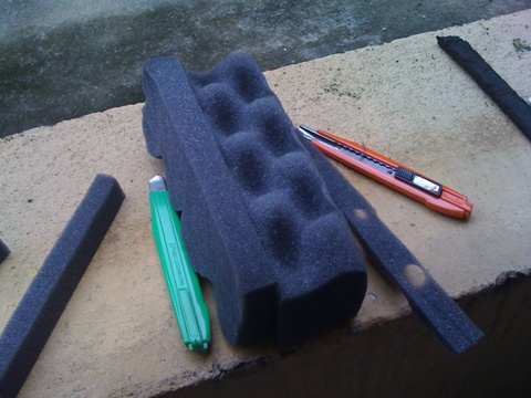

I got the car wash sponge from ACE hardware. :)
attachment.php

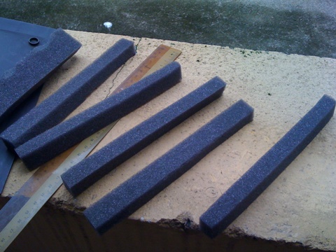

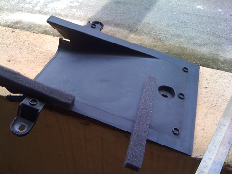

Cut them out into strips. Measure to make like original width and height.
attachment.php
Dunlop glue which I used to 'sedut' during school days.. hahaha
attachment.php

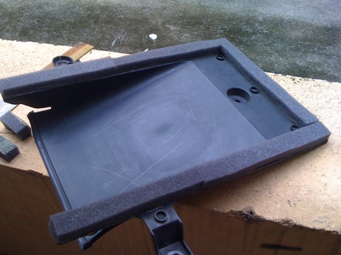

All nice... time to install.
attachment.php

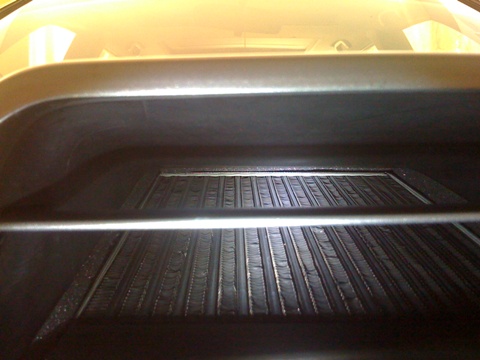

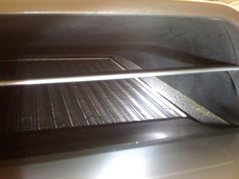

Making sure fitment is perfect.

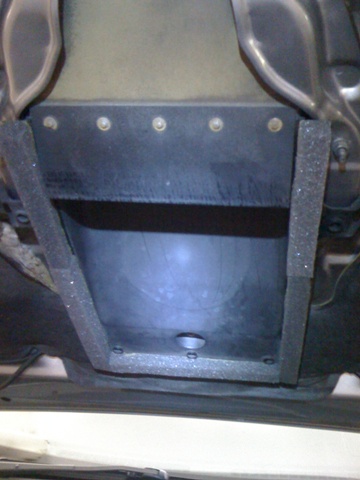

attachment.php
attachment.php
Works and looks (almost) like original. :)
