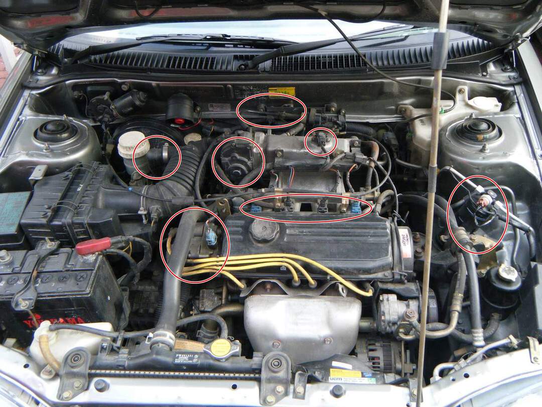

Just check these areas that is circled. MMC is different in these areas and also some other less noticeable areas.

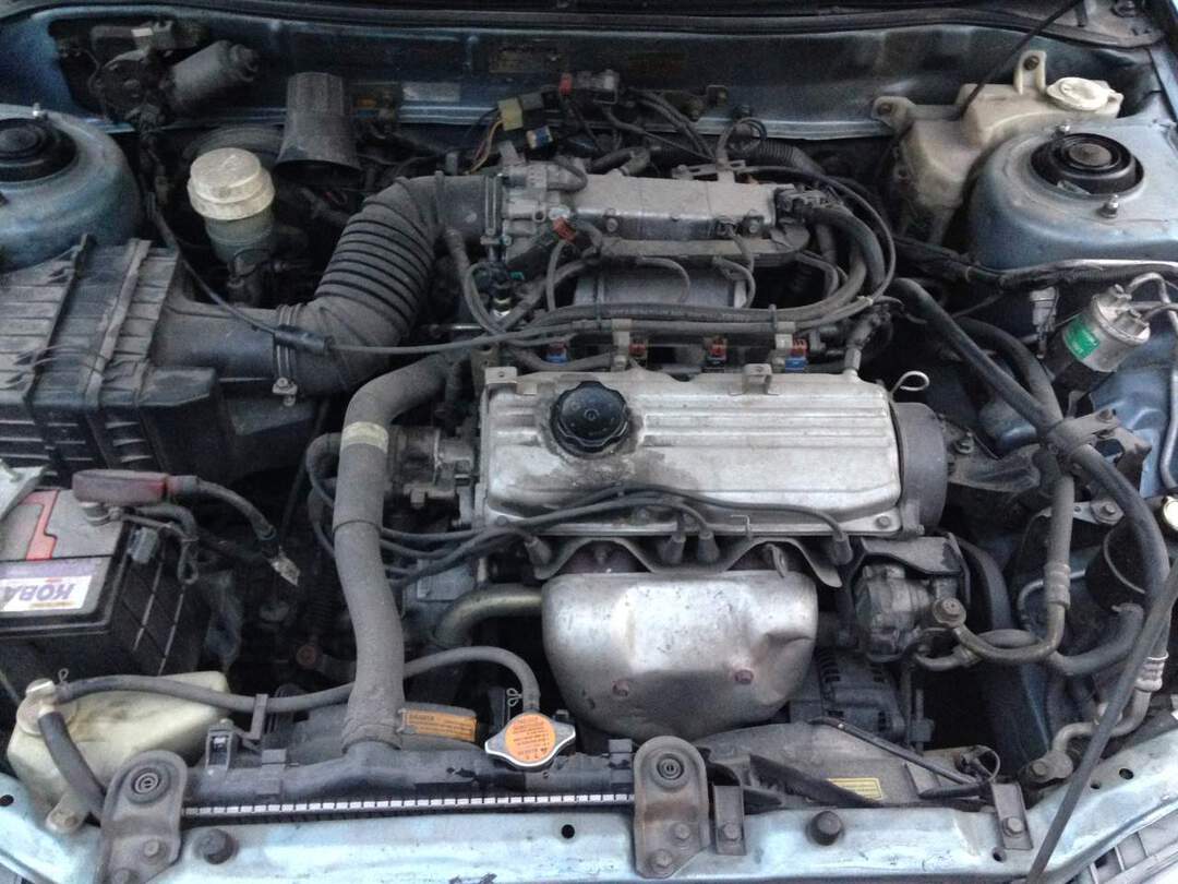

this is my engine.... if not mistaken this is MMC type right
Yes, MMC. Looks almost the same with mine but yours had one extra wiring on top of the fuel rail and injector that I don't have. Your wire is exactly beside the throttle cable.

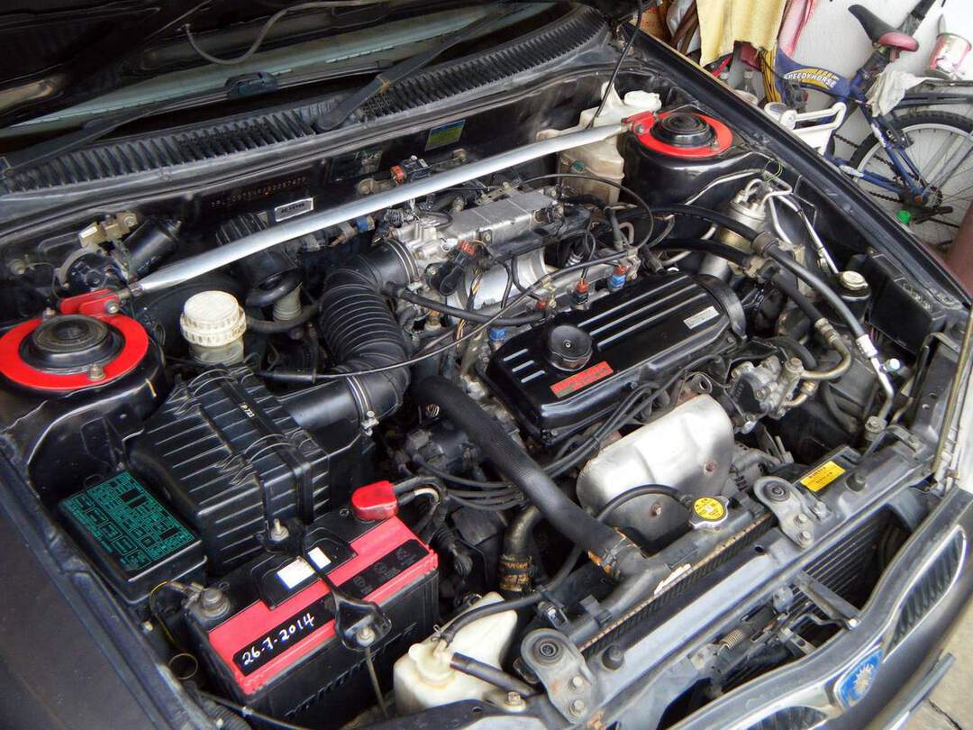

This is mine.

Bro. RENESIS showing that you need to have your engine washed.......hhahahhahah
In this picture, it looks ok but I think it still needs more cleaning especially near the block area. A lot of engine oil residue. Difficult to clean that.

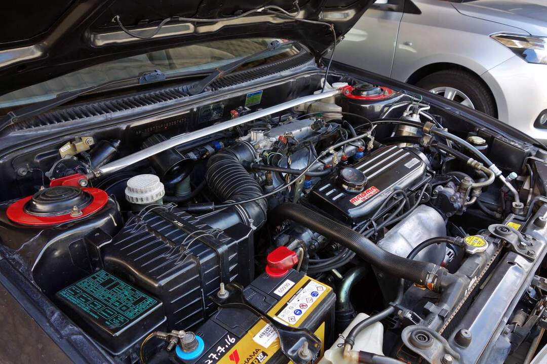

Thank you. That was an old pic. Now it looks cleaner. I din't use anything unique to clean the engine. Just wipe with wet cloth and rinse with water. Around twice a week.

Mine cincai method only. Since already quite clean, just use wet cloth and wipe away dust. Don't even need 15 minutes to finish it. :biggrin:
Only the inner hard to reach parts will clean once in a while. In those places, can still find oil stains and hardened dirt. I don't have chemical to clean those. Manually rub and rinse with water seems too slow.
