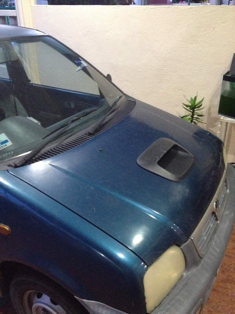

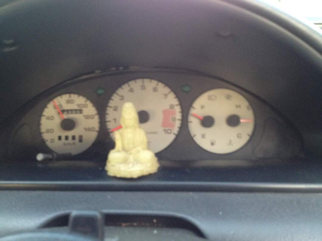

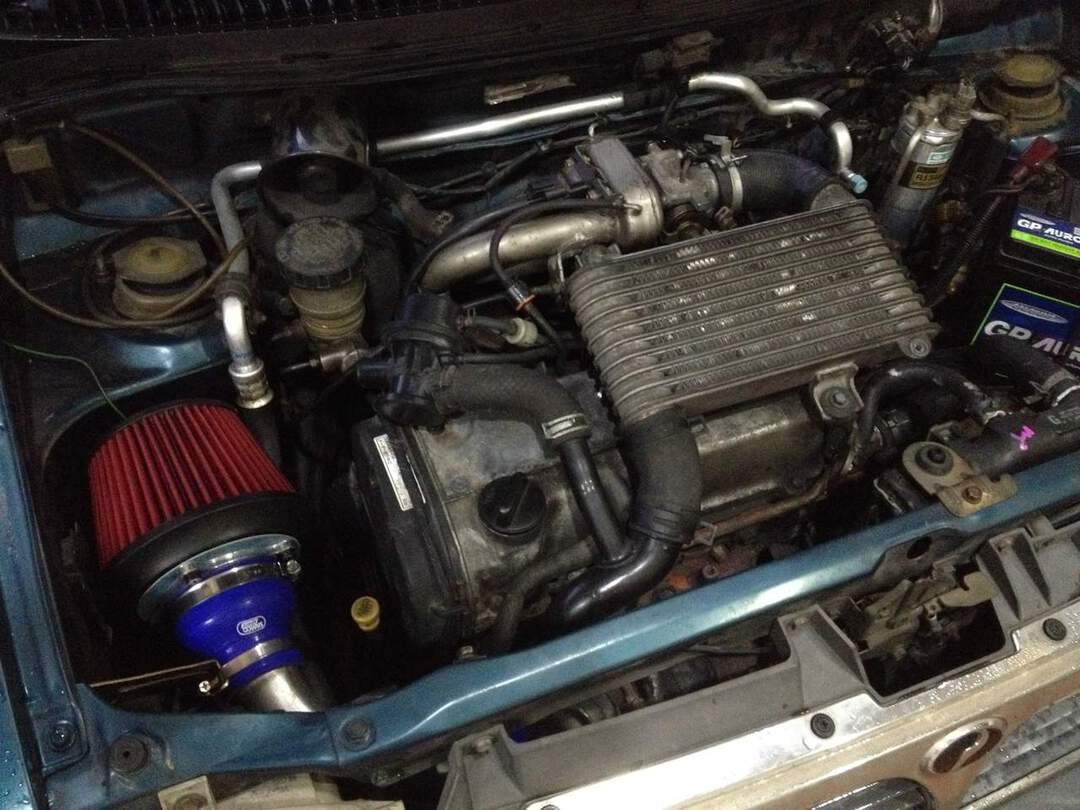

As promise guys.
My humble beli sayur kancil photos.
Engine bay, speedo and the humble scoop on da hood. =)
P/S - Please help me to identify my engine base on its outlook. It should be a L5 right? Hahaha

this is definitely EF-RL since its a twin cam 3 cyl with grey colored intake manifold.. but not sure from L5 or L6 or L7 or maybe L9..

As promise guys.
Your god is there to prevent you from monitoring your RPM meter bro? :rofl:
Anyway nice, that u have a EF-RL in your car. :top:
I think it should be a L5...my guess is also EF-RL... Now I have the answer. Thanks sifu. =)

BTW, better get ur radiator circulation checked.. i saw ur water temp is already 50%.. it should be around 45%.. go get ur radiator serviced and check ur water pump..
