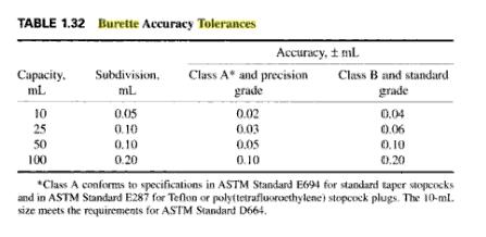

Oh, btw I checked the measuring tolerances thingy.. primarily because 0.2 sounds abit too big for a burette.
Thanks to Dean's Analytical Chemistry Handbook By Pradyot Patnaik, John Aurie Dean,
a table provided in the attachment about measuring tolerances of a burette.
The tolerances of a Class A burette is about 0.05, or 0.1 for standard grade. depending on size. Mine is only about 50cc dunno what grade (Rm150? made by some british glass company that I don't remember the name ATM)
Since you do know somewhat about measuring equipment, how do we identify grade A stuff? (I'm honestly curious, because my knowledge of these stuff is rather rudimentary, I'll admit that)

Grade A burettes normally has an A marking on them :banghead:. I normally deal with measuring equipments that comes with calibration certificates. The bigger the volume transfer capability, the bigger the errors. The +/-0.1 is for a 50mL can be slightly off by 0.2-0.3mL even some are off by 1.0mL believe it or not... oh yeah we order in bulk last time for the A grade glasswares and measuring glass equipment in which most of the time we throw away to the bin if it doesn't meet our specification. I've verified some with a calibrated balance last time.
The table will show you the accepted tolerance but it needs to be verified prior to usage.
