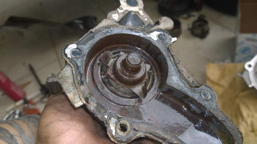

me too use the mild citric acid meant for drain clog-cleaner...and meant to use with warm water.....managed to remove a few big chunk of rust (it came out clumping like clay).......
flushed for good 4-5times with warm engine...
but i'm still unsure what was the cause of my missing waterpump blade....1-if the previous workshop didnt replace my waterpump during timingbelt change (and charged for it) or that cheap mixed various brand of coolant or imitation toyota LLC used previously (that clogged my radiator and overheated my car again) or that citric acid flush....
but no worries...replaced new waterpump during recent timingbelt change (3-4years old timingbelt if i remember correctly)

Wah! first time I see no more blades left. Even my water pump leak time change, blades are still there, rusty only.....
because i only change waterpump on 2nd time timingbelt change....so a lot of thing happens between that....didnt sure which one was the root cause... :banghead:
Even that wonder how your car was cooling without the blades......:hmmmm::biggrin:
it was doing fine....thats weird....the only occasional near overheating cases due to melted radiator fan socket only(and faulty fan motor replaced afterward)....other than that coolant temp all great..... :hmmmm::hmmmm::hmmmm:
but i didnt have thermostat for almost forever... :rofl:
Even no thermostat pump got no blade at all, so how to circulate the water?....:rolleyes:
yeah me too puzzled with that condition of blades...still the engine working fine without any temperature spike....
probably the water moves itself due to temperature differences? :rofl:
