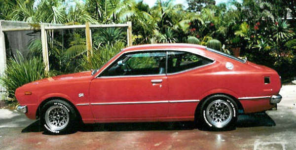

sth like this old school rims may be?

in conclusion, i just want to turn my car into sth like this...
http://img505.imageshack.us/img505/594/img23374if.jpg
or
http://www.garagedori.com/members/karls/KE35/side_high_mini_hero_86bg.jpg
I just wanna Ch'NG my car up :)) need advices from all sifus here... thanks.
