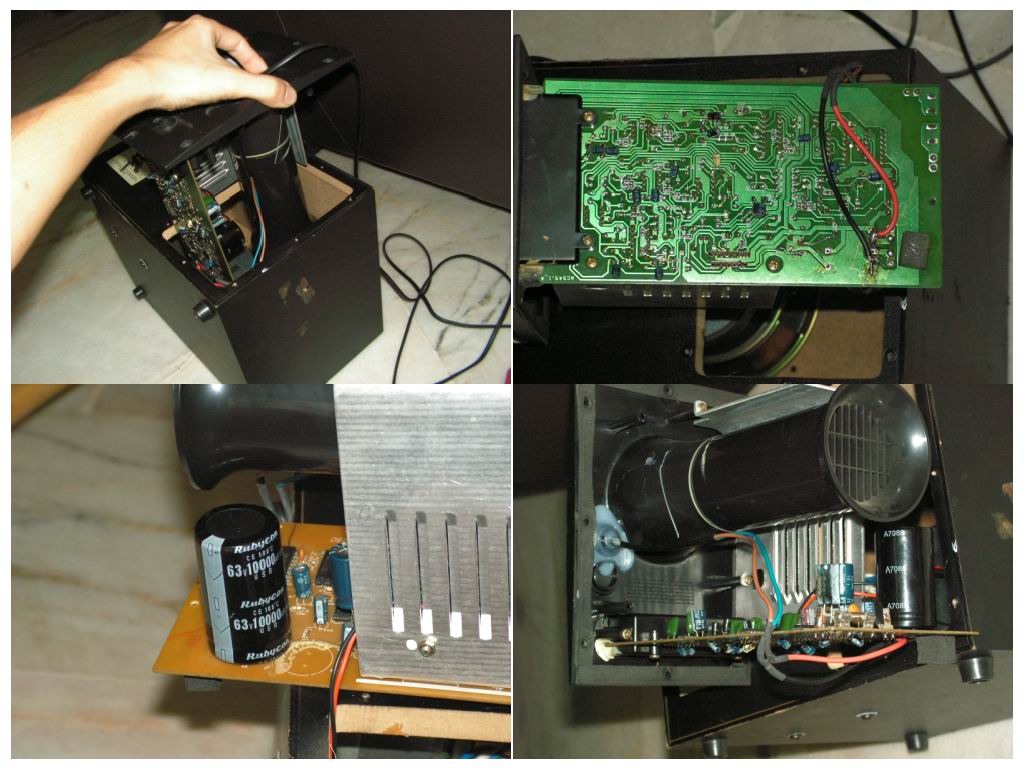

i did this mod because i cannot afford the expensive capacitors and opapms
nobody taught me how to =) just do it at own risk but it was fun!
counterstrike sound in car?
ok i salvaged enough elnas and panasonics from old car cassette head units donated, stolen and discarded. =)

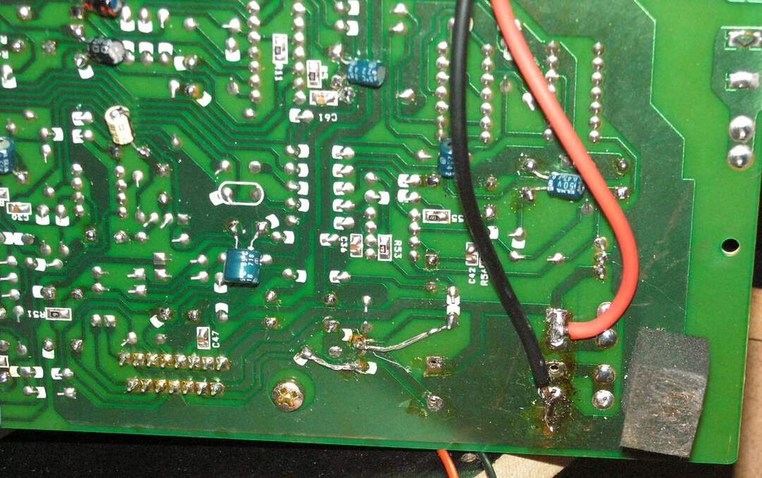

but the parts too small so i soldered them on the trace side directly, observe the polarity or smokes i guess

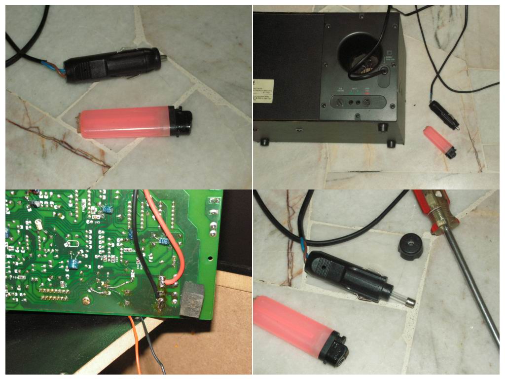

then i took out the ac to dc converter, bypassed the transformer and plonked in a (i kena conned)fake rubycon i bought from pasar road but still better than stock jamicon,samcon,capxon and some gluxon.
leave the transformer inside the box for heavier more non vibrate
no need to change the opamps 4558 because so noisy in car you'll not hear the mini details

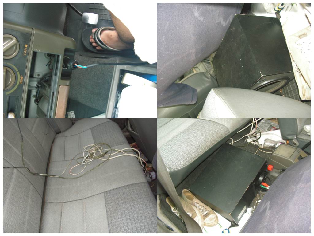

straight away put into ciggarette lighter thingy WITH fuse =) observe polarity!!
the volume control fits snugly in my crappy car! i used glue sticks to seal the satellites
card board box is to shield the sats from hot sun, later melt or crispy!
WARNING!! altec trace (the pcb underside lineslines thingy for you noobs) is very very easily come off
1# you might want to use a testpen to push the original components legs straight first (while applying solder iron) 2# then suck suck the solder and GENTLY pluck the stuff out
3# if it comes off its ok, just hot wire to destination =)

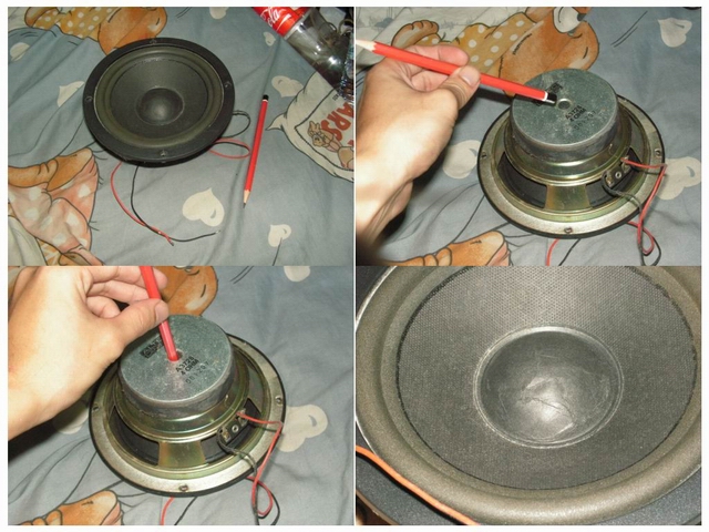

hmmn if your woofer poked by itchy fingers... you can do this repair.... GENTLY =)

i tested it in my car. and HEY! it works on the first go!
if you on max volume also you will not get deaf the power of it is just nice. sounds so like the blaupunkt cassette head unit that i stole the parts from. haha of course sounds SO MUCH MORE clearer and better than the stock ones
