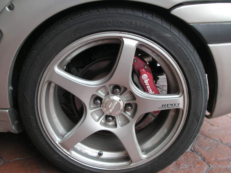

anyway im using 215/45/17 yokohama r1 tyres....running on hotbits adjustables
today i tested with 4 ppl in my car....car was scratching my wheels all the way man!
btw my car is satria gti...and i can see the gap nw between the fender and wheels are ard 1.5 fingers...will it be any help if i raise the adjustables sumore?
Bump: here are some pics
ignore the fake brembos lolx

Ok...dude!!!
I think ur tyres should be 205 width...is it?
Let me share my experience to you!!!
ADrive R1 is a performance tyres...
If i'm not mistaken!!!
This tyres always complain by all the user that alignment out!!!
So the reason is because it very very flat on the tyres surfaces!!!
i think ur chamber has been adj imbalance!!!
U can try which(left or right) cornering is oversteering!!!
Most like i guess will be left!!! Turn left oversteer!! Rig?
Otherwise, check ur hotbits adj coiler height!!!
I may sugeest u to put higher spring rate rather than higher ride height!!!
Very dangerous oh!!! 17" already so high lioa leh!!!
