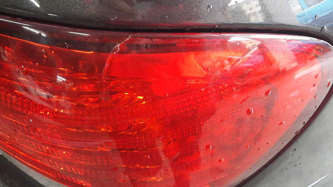

Cefiro a33 2002 taillight replacement
hex999
Oct 27, 2011
378
528
20140422_164105-jpg.516235
Recently dont know how one my taillights got cracked, I plan to get a halfcut version and just got to know that the JDM version does not fit our current local model, need to change bonnet to make it fit lol. So anyone planning to sell their taillights? or any other options? Tan chong selling a brand new one for RM500 lol.
What I would do is, goto the headlight tint shop, put a red tint over it.
At least water won't get in :)
DIY bro. Just apply those multipurpose epoxy glue (harden under 30seconds ones), that comes in those small stick.
Shelly brand is quite ok. Cost about 1.80 per stick, comes with a fine applicator nozzle. Use sparingly though.
The epoxy is watery, and it will seep into the fine crack via capillary effect, and hardens upon contact. It will seal the crack easily.
No need to buy new lights or even stick film over the crack.
