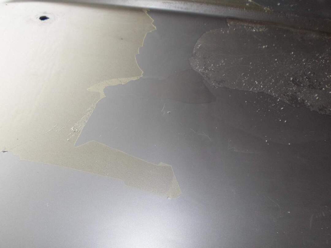

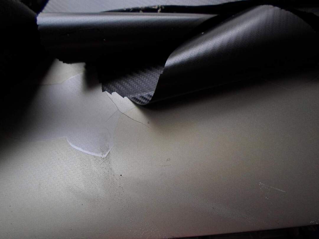

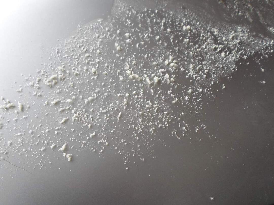

My car was stick the matt sticker 1-2 year ago .the problem very difficult to tear of the sticker and harm your car body colour !horrible !ShxT !many plastic glue stick on car body and some primer come up. Is worst and dissapointed.
The whose sell the sticker say "this is the very good one sticker ,won't harm you car colour ,easy stick easy tear it off ,air bubble just press will gone .Sound good but no effect.

This is the same for those cheap-ass tint flims. The cheapo ones would peel off leaving gum stuck on the windows that takes ages to clean-off.

I've experienced wrapping my bonet with the 3M's vinyl. After 4-5 years of using it i decide to tear it off. The vinyl already rot and hard to peel when the surface is cold. So i heat the surface and manage to peel the vinyl easily without any residue or leftover. :)

from what i see, it looks more to paint defect.
Thread starter : how about you reveal the sticker brand?
kinda wondering, if the adhesion not strong enough then u claim the sticker not good. only 1-2 wks peeled off let say.
i think when u wanted to peel it off, u should heat the surface with a heat gun to at least soften it since after all it is 2 years yo.
