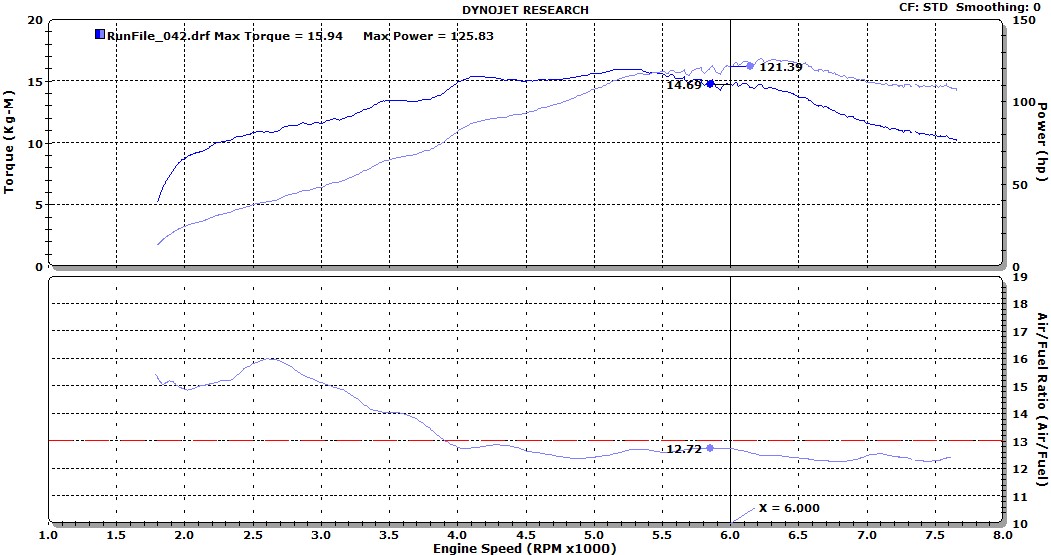

****** Car and Full body Gen2 making 125whp stock OEM engine.
2nd Place Melaka Drag 2011
Engine Spec:
Campro 1.6L engine
Stock bore Piston Campro 1.3 BLM
Stock Intake
Stock Cams
Exedy 4 pad Clucth
Haltech Sprint 500
Tuning on Load Dyno Jet 125.83whp
Torque 15.94
Fuel Petronas 97

So the haltech with high compression piston do the magic?
No Magic..but true tuning and rite ignition timing on your engine.
---------- Post added at 08:35 AM ---------- 6 hour anti-bump limit - Previous post was at 07:55 AM ----------
dont look the high Hp on NA engine when u tuning,bring the high torque to push your car on top.

Thanks for the reply and advise. I know no magic la, but my meaning is like magic bring the potential out.
Cuz I'm driving a campro too, I need more pick up and power to accommodate my bigger rim.
