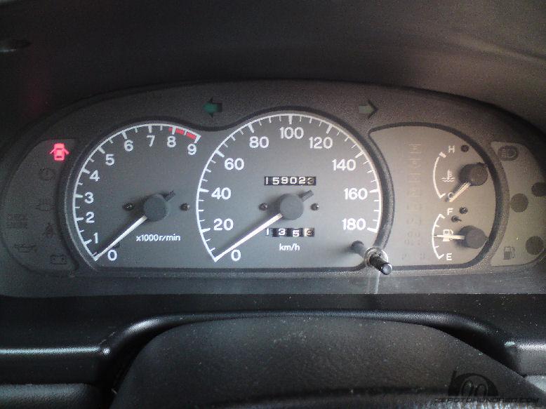

the meter he using 0-180kmh .... then he put the white meter cluster 0-240kmh .... the white meter cluster is design for 0-240kmh meter (such as gti , putra) ... of coz the speed will high at the meter ... actual as slow..
example :
driftingart
http://i230.photobucket.com/albums/ee7/driftingart/wira16.jpg
he suppose to buy this cluster ...
http://img2.mudah.my/images/22/2242232895.jpg
