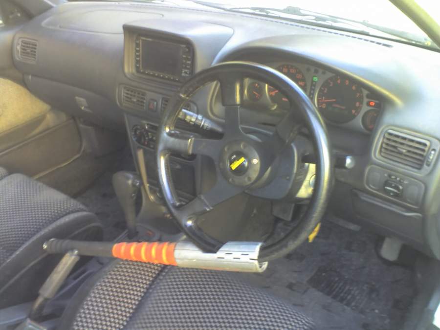

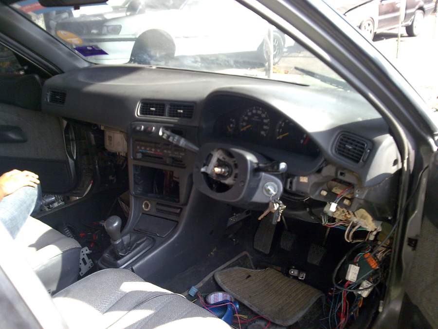

Can but need a few mod..
better find experience w/shop..
My car oso using bt dashboard..nice maa..
Bt dashboard on ae90.
