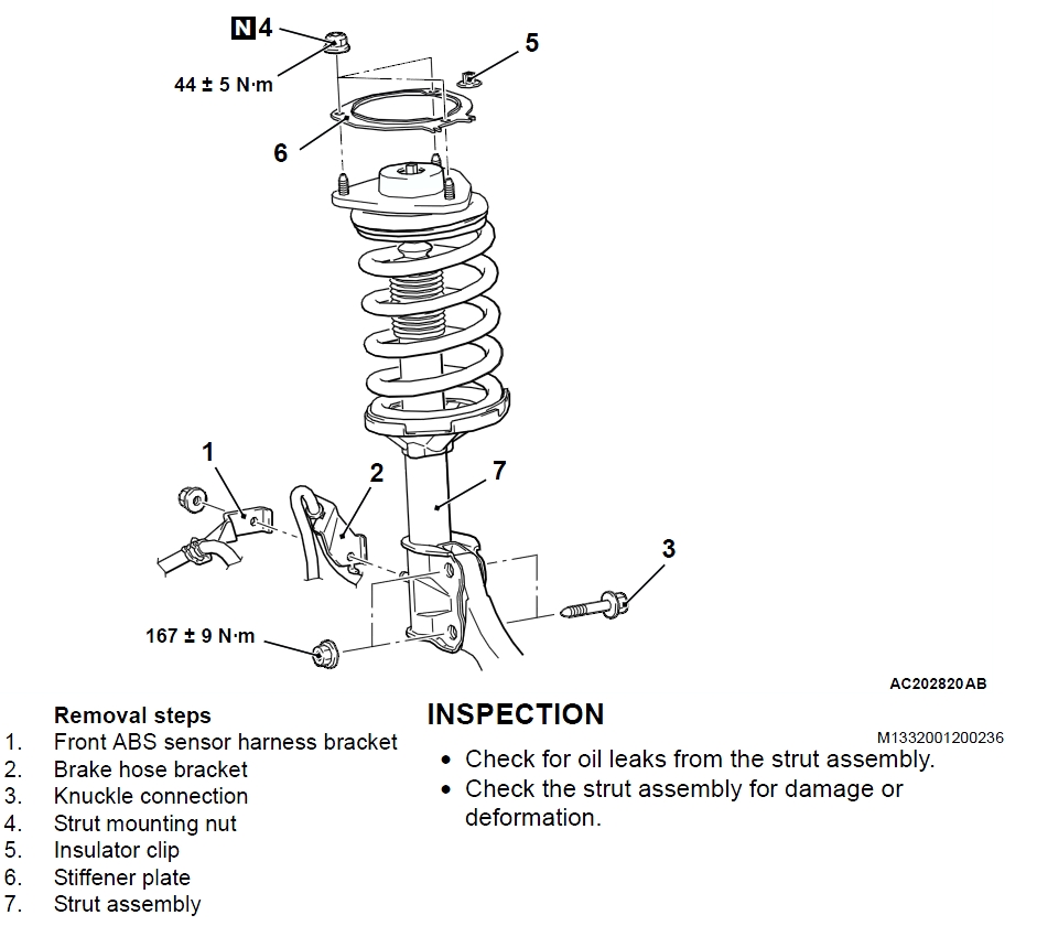

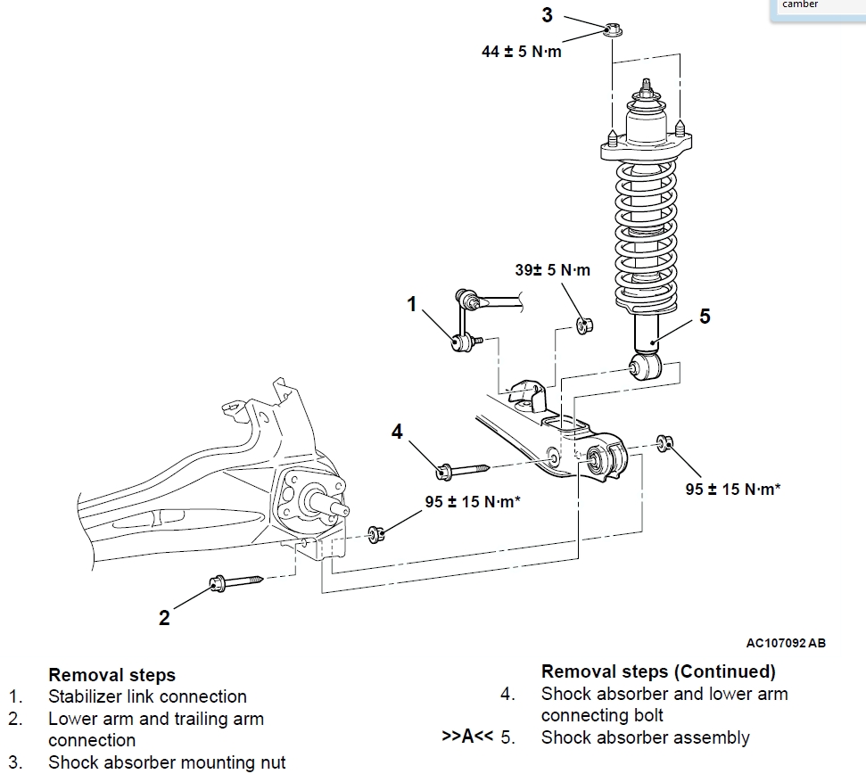

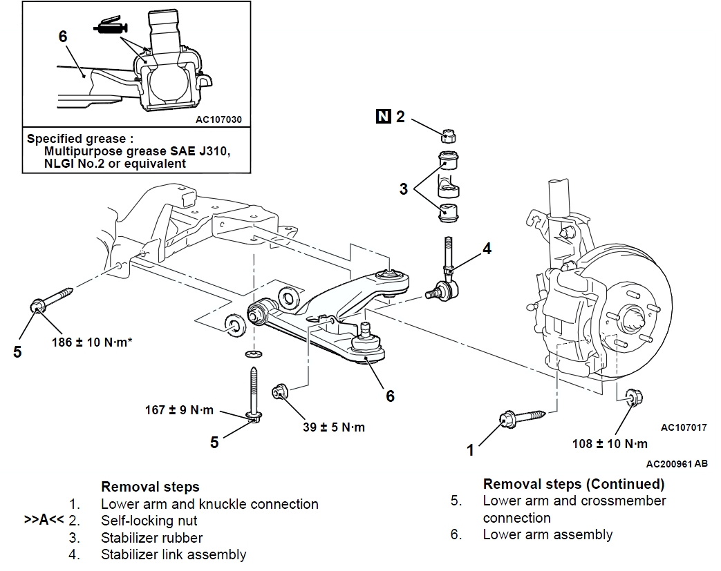

attached are the assembly diagram for front and rear suspension and arm.
could you show me where is the adjustment point?

bros,
i couldn't find anything saying that either front or rear camber can be adjusted.
and for the rear it is even mentioned explicitly that camber can't be adjusted.
i assume for the front part u already understood that the camber screw was used to achieve the desired setting
attachment.php
*screw no.3 in the above picture...but the top screw...not the marked number.3 screw...
for rear link u can see in this picture..item no.1 with screw that have offset washer for adjustment...and there should be another similar screw with offset washer located at lower arm marked no.6 in this picture below
attachment.php
and for alternative in evo3 short link, there was adjustable short link for evo3...not sure for the later evo/trek....(item no.2 in rear assembly picture above)
