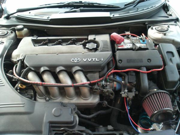

allance Known Member Senior Member Joined May 12, 2009 Messages 337 Points 1,518 Jun 15, 2009 #2 Re: CAI on standard airbox stock airbox is already have cool air intake design bro! if u want to DIY CAI u need to bore ur airbox, under the airbox have 1 small hole, u can install intake ram kit at there! Attachments 438337716l.jpg 47.4 KB · Views: 191
