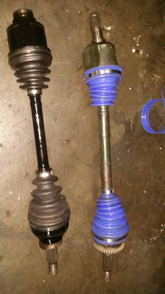

Kurt,
How much is drive shaft per side?
ermm, if I remember correctly
The one in green, is from evo, cost me rm 350 and I also modify the rubber to silicon type.
the one in black, is v6 type, cost rm280 for a recon.
my mechanic told me, sei is actually more suitable.
I only know drive shaft is expensive and common problem with perdana, always need to change.
this is the 3rd time I am changing again
