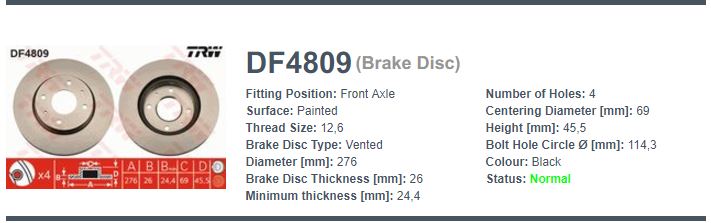

Current standard set up is 276 MM vented as per here:
