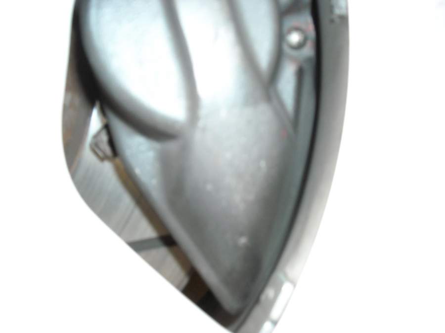

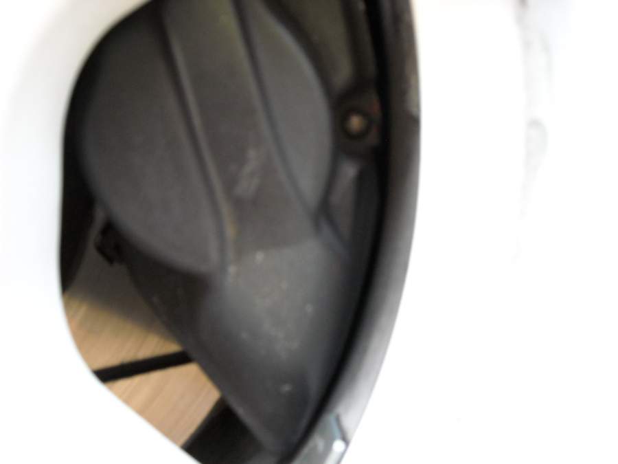

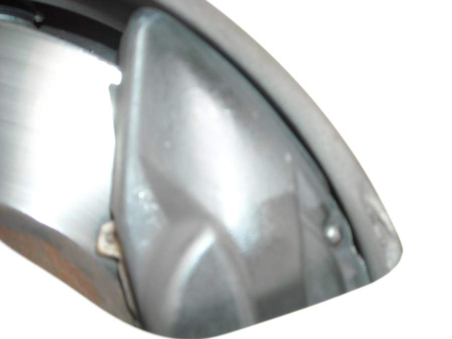

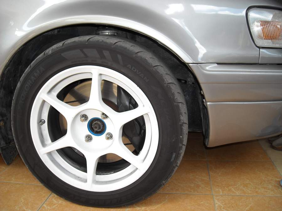

Thanks to one of our lobang king,Ivan, for selling me this brake from his halfcut.
He could have used it himself, but yet he's willing to share his halfcut bounty with others :adore:
Also thanks for the Japan guy who mod this celica caliper on the AE knuckle, for his hard work,
I only have to pay $80 to my mech to install to my car.
Caliper =Celica 4 pot ( some people going to flame me:bawling:, but I had to grind the edges of the caliper to fit 15" rim)
Disk = 300mm
Rim = 15 inch Buddy club P1 ( offset 27) clear caliper without use spacer
Brake pump= Levin double layer
Brake feel of the car now, 50% improvement over twin pot brakes, hehe...
Share some pics....

wonderful upgrade bro...very small clearance! best stay away from potholes! and what adjustables are you using? i'm considering to change my stock setup :)
Wow.. seriously man... really teeny clearance from the photos.
I guess you're maximizing your rim size huh?

if i no mistaken... If using the Celica (not sure which model), the caliper can be nicely fit our SE, SEG... with very mirror mod only. The bracket about the same only.... 1 of my friend also use it... but need to use 15" inch (min) rim for clearance....
would be nice to use celica brakes but with all the holes in the road in malaysia, i really dun dare...would go for minimum 16 inch just to be safe :P but that's just me :)

wow very small gap..just like my friend use toms 14 inch rim with Blacktop single pot brake..
i'm also using caliper frm celica (3sgte), just p&p the caliper to the levin disc.
minimum is 15", and still got better/bigger gab compares to mamatae111's .. BUT..

really nice installation...waste abit for the disc skimming...
if use 16" rim with the original disc size that i sold u will be nicer...hehe!
