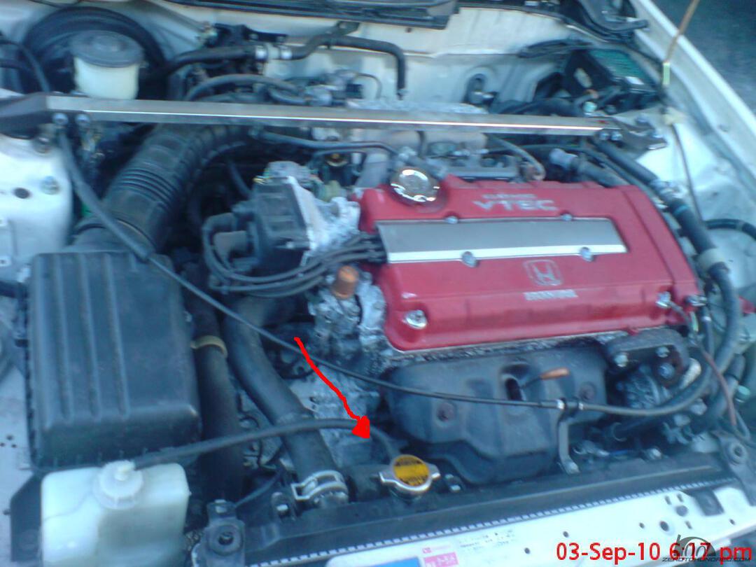

ok i give u see the picture ... this half cut model is DC2 Tyre R . bro can u tell me how to find out its gsr or b18cR ???

if u wanna check the block whether its a type r.
theres a engine code besides the gearbox.near the extractor.
it should says b18c5
gsr is b18c1.i guess la.lama tak maen vtec.hehe

[/COLOR]GSR and type r manifold not same 1... i find out already ...

and you've just answered your own question on how to differentiate type r and gsr. the intake is a giveaway. the gsr is the one and only engine which uses the upside down intake.
