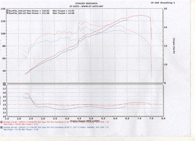

ic.. but one of neo r3 owner get 8whp increased just by doing proper tuning to FPR for better air fuel ratio.. stock reading is 121whp.. final reading 129whp

It's me who get that 8whp... And i get it from Dyno tune... To maintain the AFR, there will be no engine blow because of it, its been dyno for OPTIMUM level..
So your statement about "hope their cars fuel line dun burst.later go kaboom for ur car" is not relevent for me as im using Dyno tune as guidance (with wideband sensor) not using try/guessing and error method.......
and i got evidence to support this...
But actually yes.. FPR dosnt increase HP actually.. i still dont know how i get 8whp...(BTW im using Ron95 at that time...) this make thing more confusing....
PS: Blue is before adjusting the FPR

its not that im against GT AUTO but ready to lose 5-7 HP if u do dyno at any other place (dynojet only)..n FPR wont gain that much of HP
Errrr, il try to scanned other places where i dyno test .. I get around 128.9 whp.. so that mean same as 129.02whp at gt auto . BTW they are using dynojet too ..
Plus humidity and temperature factor can change the outcome~ (about humidity i dont actually confirm).
PS: i dont think GTauto that bad because there too many high performance car tune there and i dint heard any bad review from them till now...
BTW, about the gearing oh well, that's why im there, to ask them try all of the gear, (dint test for 5th gear actually . .) that's why as you can see i test for 15 round not 3 time only~

Cume nak tekan kat sini, aku pun xpaham knape dgn ape yg aku buat (minor2 thing je pun) dpt dlm 8whp.. itu je.. dah la time dyno tu aku gune ron95~ yang buat aku terover ni sbb sume nak spam yg itu xmungkin ini xmungkin.. mmg la aku taw xmungkin, tapi dah terjadi.. Ingat nak carik jawapan camne.. tapi sume buat2 pandai jawab mende lain...

secara logik figure tu boleh dipengaruhi beberapa sebab:
1. power to weight ratio cth berat neo, gen 2, pesona berbeza walau engine campro
2. jenis tyres yg diguna cth neo R3 guna RE01 kategori UHP yg lebih grip berbanding tyre entry level
3. jgn banding pd keter yg lain krn gear ratio yg diguna berbeza
4. mungkin berat roller berbeza diantara setiap mesin dyno cth penah dyno di Links figurenya kecik dr kedai lain
5. unit ukuran yg diguna hp,bhp, whp,ps dll pd mesin ada selisih bezaannya spt metric dan inchi, kaki
biasanya dyno sblum mod dan selepas setiap mod pd keter tu, buat bandingan dgn kwan yg mod sama pd neo R3 yg lain dan akhir skali test sebelah2 atas jalan dgnnya dan R3 stock kilang...
mungkin akan terjawab...
